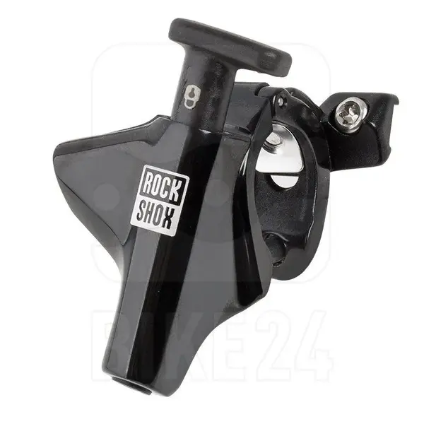

Now my forks work nicely with an extra bit of travel but the only thing that has let me down is the crappy RockShox PushLoc remote that locks out my forks, which has blatantly refused to work as it should.

I've never had a problem with the lever as long as it is set up properly. You need to ensure it pulls enough cable, so when you put the dial on the damper, it has to be far enough round.
Other issue is, if there's not enough oil, it won't work.
The floodgate adjuster might need, er adjusting as it affects the lockout function. Too little and you'll never get lockout really.
Not got floodgate on mine (2013 REBA RL), have checked the mechanism and it returns fine but soon as lever is connected it won’t work, it’s the lever that’s at fault, only problem is that CRC only have right hand versions on sale at the mo. Thanks again for your advice on rebuild btw, it’s made me a lot more confident to tackle the black art of fork maintenance.
If the lever is all black, the one where you push down on a plastic thumb shaped lever, then they aren't the best. I have a broken one in a box, the plastic bit that catches the ratchet broke off. I was thinking of using it as a dropper post lever as it doesn't stay down.
There are 3 main versions available that will work on your Reba forks – see below:
As Ian has indicated, the plastic versions are not that great, but I have used both versions for years with no problem.
The last version has a momentary switch action – push on the lever to lock, and push on it again to unlock. These are better quality.
Which version have you got that is giving you grief?
