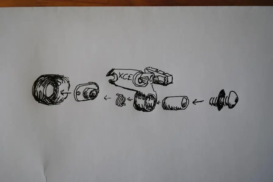

I'd guess the cylindrical Bush goes in the hole to mount onto the frame brake boss. The bolt then goes through it . The spring goes in the back and one end locates into a small recess in the brake arm, the plastic cap goes on to cover the spring.
Dunno about the other bit though, maybe goes onto the frame brake boss first and then the end of the spring locates into it from the looks of things?
does this help.........

And now that you know how to mount them, then you need to set the tension right, which is done with a fixed key (usually a 13 mm and the fixing bolt, tightening against each other the same you would do with a threaded headset.
You can see the explanation from, who else, Sheldon Brown, at around the middle of the page:
http://www.sheldonbrown.com/canti-trad.html
