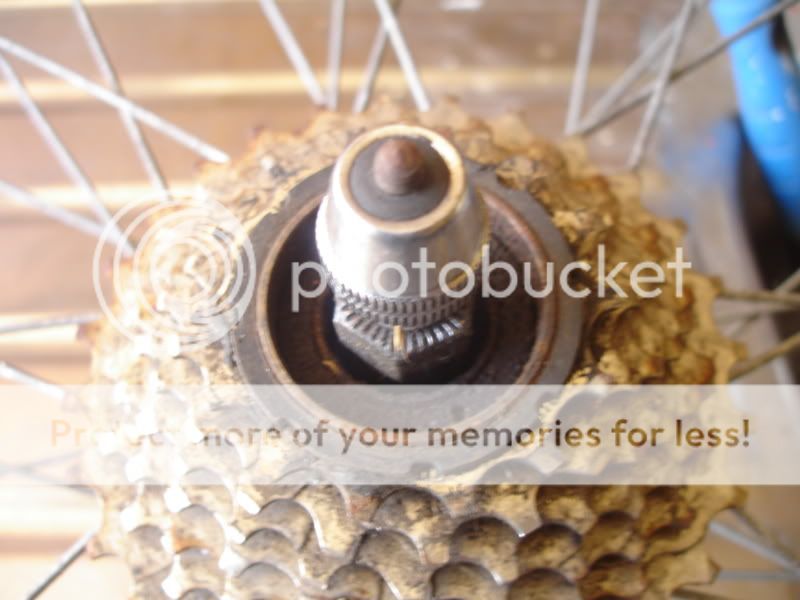

How do I get this cassette off?
The one that's in there is 142.. give or take...
Wondering what a 170+ would be for...
Is the freewheel/cassette option governed by the hub?
This wheel is the rear for the kids trials, I'd like to get it back together so they match..
Prob do some measuring and put an ss freewheel on.. I've tried to get them to use gears but they just don't :?

Are the splines like on this one?
park tool fr-1 or equivalent if so. The lockring doesn't need to be removed.
Or there is always destructive removal :lol:
That is exactly what I am facing..
And this sounds great (having just tried to clamp something in there and failed miserably).. I've not worked out how to rip the mofo off with maximum force yet :?
