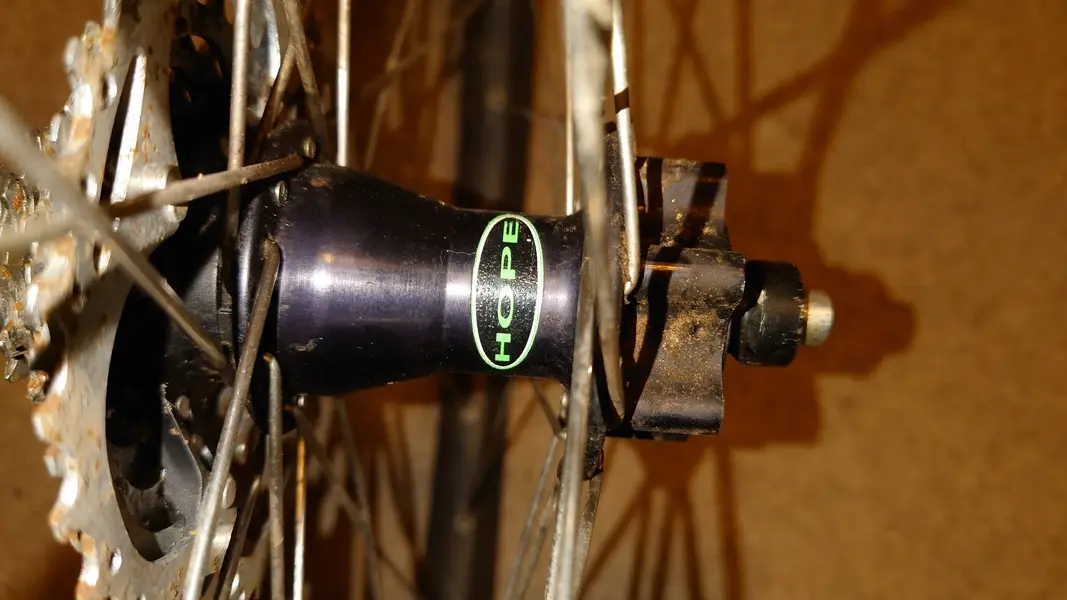

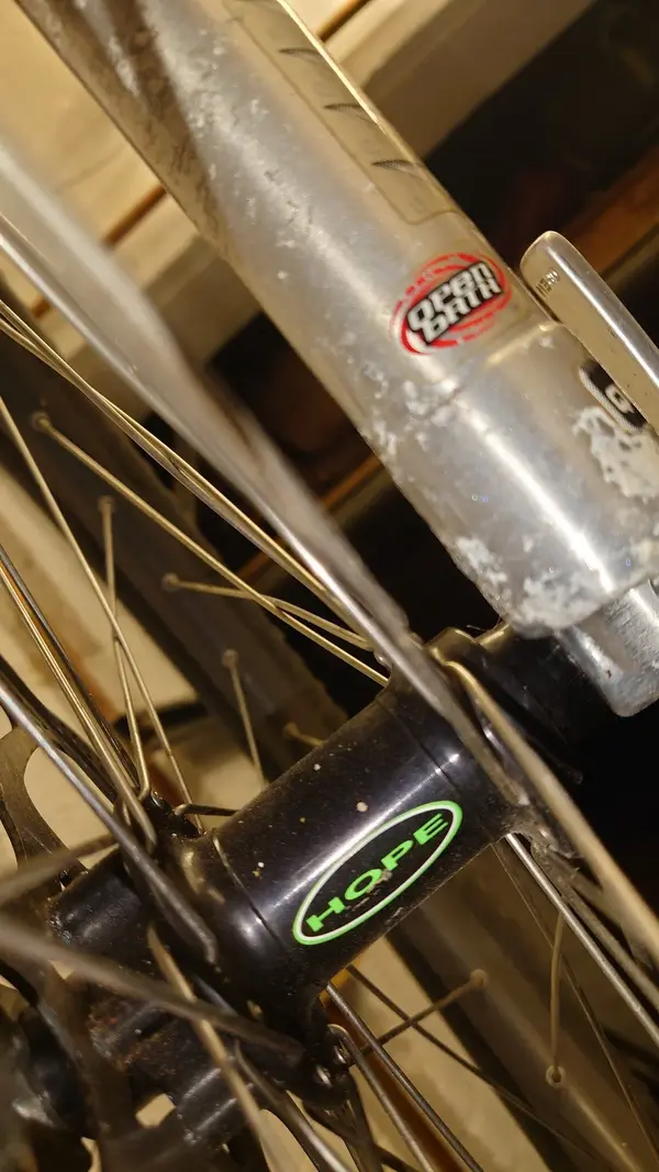

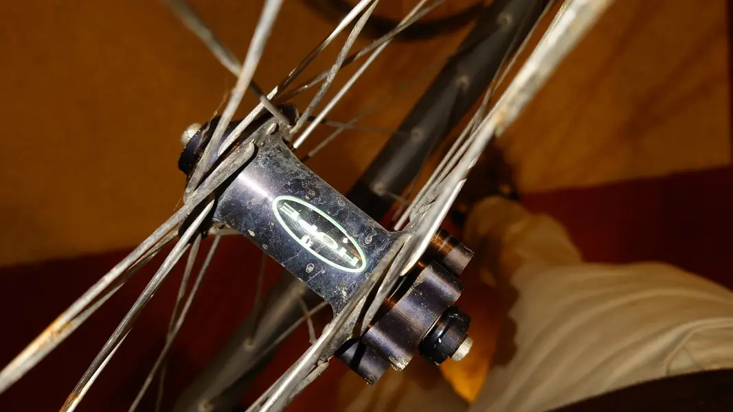

As I have both Bulbs and XC hubs, I think I can help with an easy way to identify your hub visually.
Hope Bulbs have a small lip next to each flange on the front or next to the flange and 'slope' on the rear, as can be seen in the photos below.
The Hope XC hubs don't have a lip and are smooth.

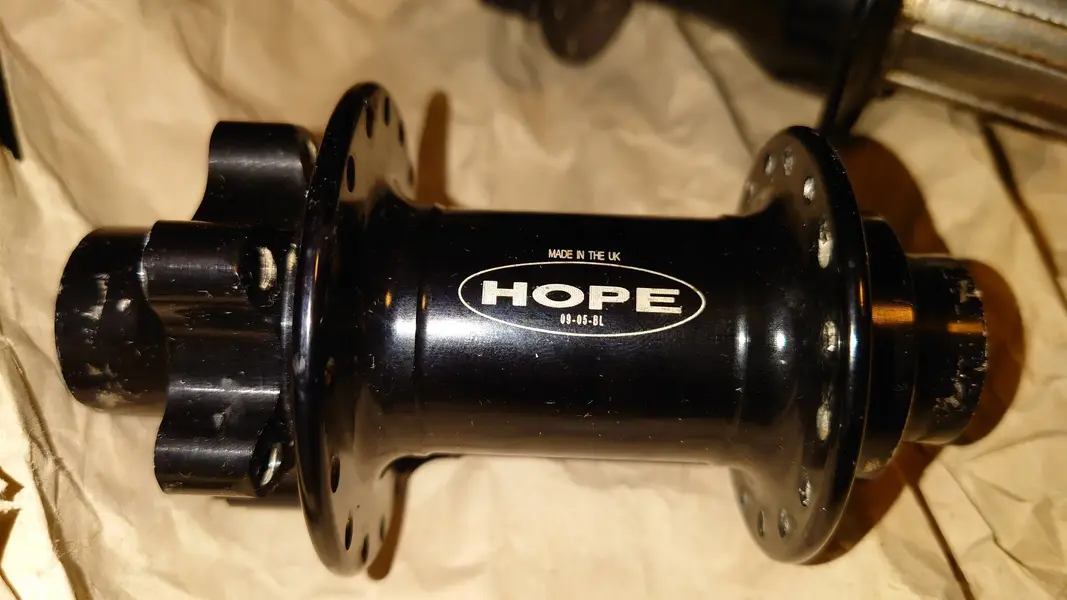

With later hubs, identification is easier as they are laser etched. Bulbs still have the lip, but have 'BL' at the end of the serial no. The XC hubs will have 'XC' instead.
