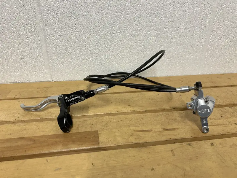

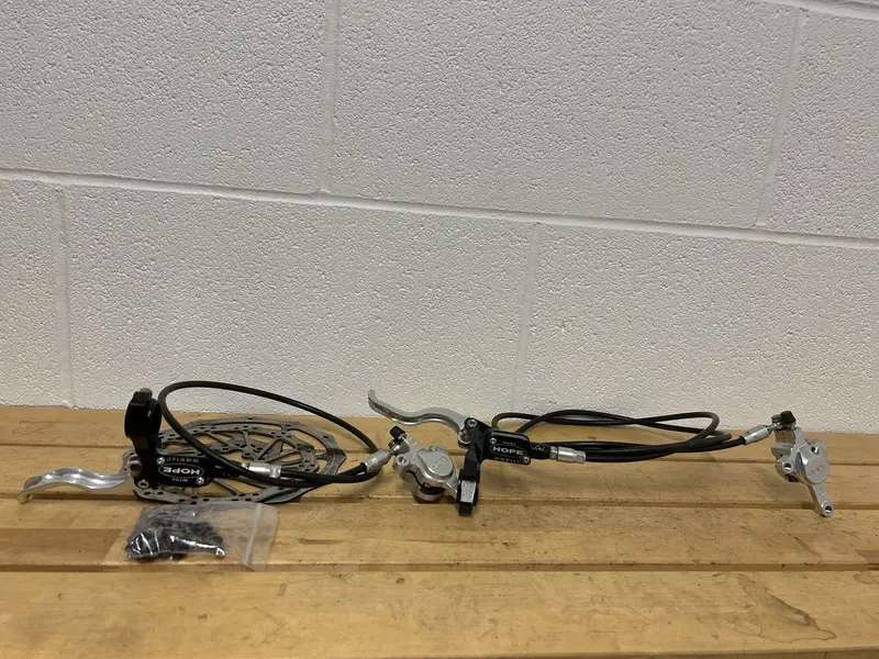

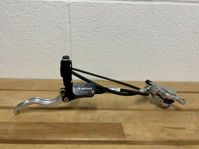

Hope brakes
Used condition

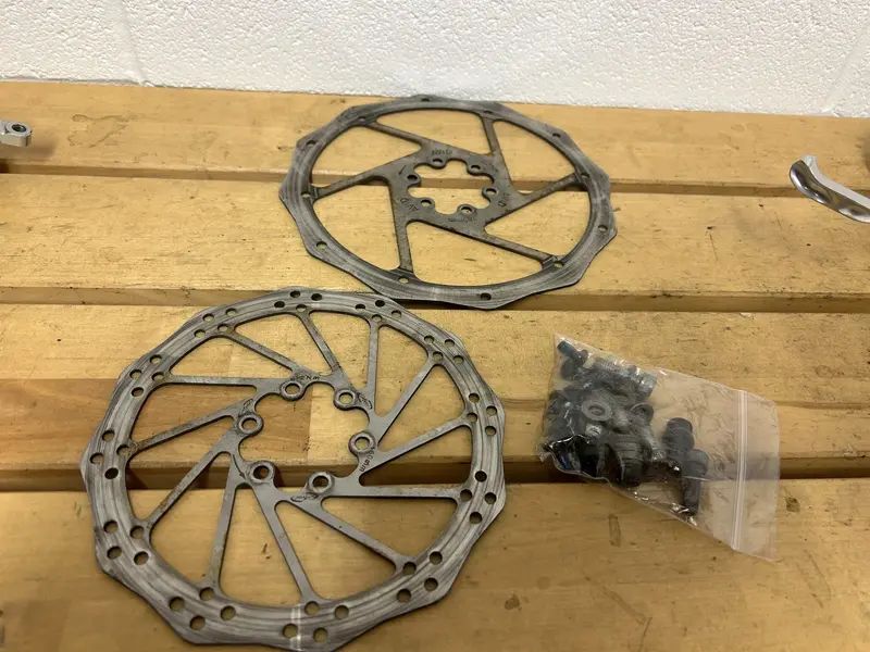

Avid rotors
I’d recommend a service and inspection prior to use.
£65
Price inc UK postage. Payment by paypal gift or fees covered please.

Would it be possible to set these brakes up as 185mm front using the post mount adaptor, 160mm rear I.S. bolted directly ?
I'm wanting to replace the brakes on my wife's Cannondale, it's currently got horribly corroded Avid Elixer brakes. I run Hope brakes on both my Lefty Cannondale and my Zaskar LE.
Cheers
For reference, a no.5 caliper fits a 165mm front and 145mm rear IS mount and a no.3 caliper fits a 185mm front and 165mm rear IS mount. None of the 2 piece calipers used 140/160/180 rotors, only 145/165/185. A Hope HBSM20H postmount frame/fork to IS caliper adaptor adds 20mm, therefore that would make a no.5 caliper 185mm at the front, or 165mm rear.
