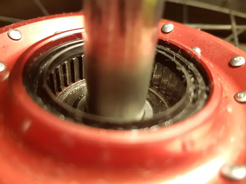

Clean it all up and post a pic, including inside the hub, as not to worry you, but if a pawl comes loose, it can gouge its way around the inside. Best look before committing money to anything.

Ok so i've got the freehub off and had a look at things. Pics attached as asked. :D

From your pics it looks in pretty good nic, as long as the axle is sound and straight I’d just replace all the bearings, pawls and springs and put it back together.
Just be careful, the spacer that’s goes between the hub bearing and the free hub will probably be a slightly different length to the one that’s between the 2 bearings in the freehub so don’t mix them up. And remember there is a circlip in between the 2 bearings in the freehub. Hope that makes sense. Oh and red is the best colour obviously.
I'm glad its all looking good inside and the axle is fine ...so if i just got new pawls and springs would the loud "Hope Click" return? ...or would i also need to replace the ratchet ring to get that sound back?
Also, and not that i really need to, but if i wanted to replace the bearings, would i need any special hope drifts to get the old ones out?
Wratchet ring looks fine - doesnt look like the springs are in the pawls as they should sit proud
Given its age the ring just needs a light cleaning and some light grease and it'll be good to go

I’ve got several of the Hope drifts but that’s just because I have enough hubs I felt it was worth buying them. But if that’s your only Hope hub you should be ok to use an appropriate sized (as close as you can get) socket as a drift.
Like Boxxer said the ratchet ring just wants a wipe/degrease while the bearings are out and then a small amount (too much will stop the pawls springing back properly) of grease when you put the new pawls and springs in you should get the Hope click back.
