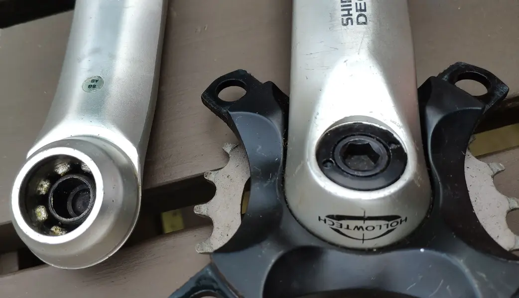

F fullerlee Old School Hero Mar 7, 2021 #1 Hello Does anybody have an axle for Hollowtech 1 crank as pictured? Thanks Attachments IMG_20210307_121755.webp 428 KB · Views: 201
captaincowelly Senior Retro Guru Feedback View Mar 7, 2021 #2 Re: I'm assuming it's a bottom bracket you need? Do you know if it's 68 or 73mm shell width,and what length axle?113mm?118mm?
F fullerlee Old School Hero Mar 7, 2021 #3 Re: Yeah, somebody on Facebook just pointed that out, I'm not doing well with this . Thanks.
ishaw Gold Trader GT Fan Feedback View Mar 8, 2021 #4 Re: Can't tell you what shell width or axle length you need, but I think the bb model number you need for the xt cranks is es71.
FluffyChicken Archivist Retrobike Rider Feedback View Mar 8, 2021 #5 Re: Re: ishaw":x6nqye0g said: Can't tell you what shell width or axle length you need, but I think the bb model number you need for the xt cranks is es71. Click to expand... Any of them will fit the M750 (ES70 was the original) in 113 or 118 (for the different chainline). One tick, here's your setup F650D https://si.shimano.com/#/en/SI/F650D A quick look shows Es300 is the current Shimano bottom bracket they sell, seems everywhere lacks stock. The older ES25 or if lucky the higher end old ones may be found.
