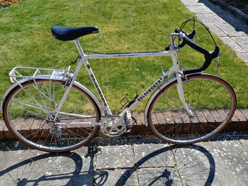

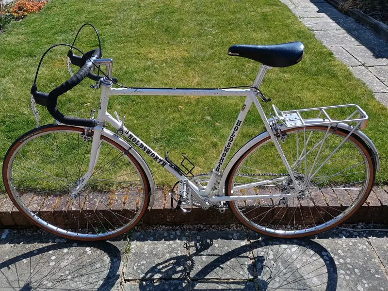

This is my Dad's Holdsworth Mistral road bike, frame number 7513, size 23.5". The Reynolds Ti decal suggests it is a 80s frame, I can't make sense of the CB/Holdsworth frame numbers on the page on the forum (apologies to the authors).

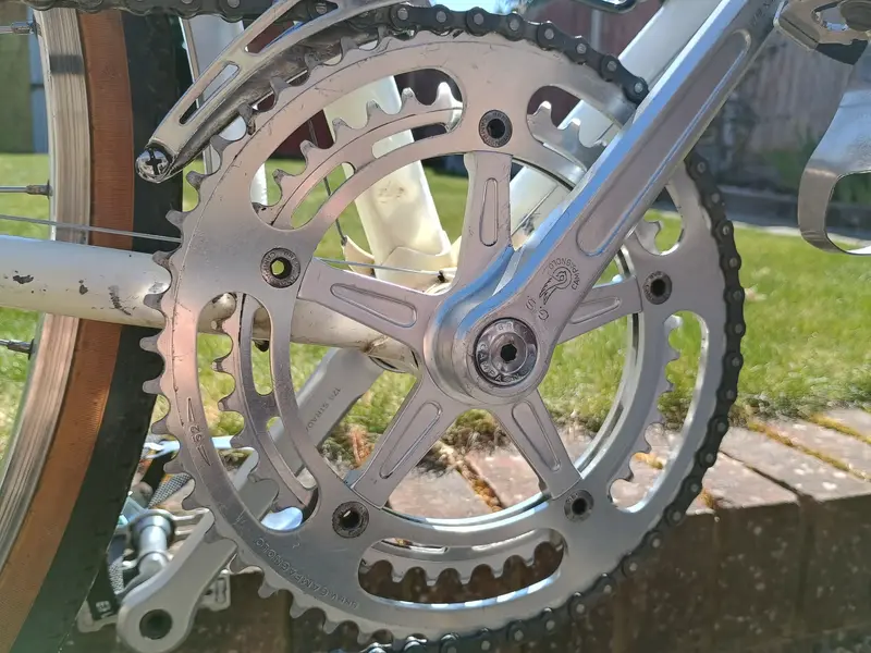

Clearing the family home now prior to sale and I said I'd do something with the Holdsworth, which has been sitting inside gathering dust. I brought it home with me and had a look at it, not knowing a lot about Holdsworth bikes. First job was cleaning 35+ years of grime from every part of the bike - I think Dad's anti-theft tactic was to never clean anything. The frame is 531 forks, stays and tubes with Campag drop outs. Years of patina are evident in the paint that remains with an interesting dent in the seat tube near the bottom bracket on the drive side...also Dad's party trick of touching in scratches with gloss house paint😁.
Here's the components -
Suntour SVX 6 speed front and rear derailleurs
Shimano freewheel and chain.
Suntour Power Shifter clamp on friction gear levers
Campagnolo Gran Sport Strada chainset and cranks, Campag bottom bracket that needs a service.
Mafac drillium brake levers and hoods
Weinmann Vainqueur 999 centre pull calipers
Lyotard pedals with GB Professional toe clips/Christophe straps
ITM Special handlebars,Cinelli cork tape, unknown alloy stem
Turbo Special leather saddle (comfy)
Unbranded alloy seatpost
Tange headset
Wheels are 36 hole Specialized sealed bearing quick release hubs (silky smooth) with a Mavic Module 4 rim , galvanised spokes, at the front and a Mavic rim bearing a ' handmade by Mercian' decal on the rear, with stainless spokes . Both run true.
A combination of Schwalbe and the inevitable Michelin World Tour 27 x 1& 1/4" clincher tyres are fitted.
Alloy rack and Esge chromoplastic mudguards complete the parts.
So nothing exotic but all reliable and useable after a clean. To get it more rideable/safer I have changed the brake inner and outer cables, rear gear cable and outer , replaced the rear tyre for something less bald and fitted the cork handlebar tape. Also found a lot of loose brake nuts, eek.

It's a nice steed with decent components. Very noble to donate to a charity and if you think your dad would approve then that's the way forward.
Thanks for sharing the story of your Dad's bike. It really highlights how even with a degree of neglect these old steel bikes just keep on going. It cleaned up nice. I'm sure it will find a new home with someone who will ride it and cherish it.
A lovely Holdsworth, which holds some great memories. If you can't keep it, then certainly someone else will enjoy it via the charity.
If it is a custom build, the frame number suggests it might have been built in 1976

Thanks for the frame information, interesting as the current spec isn't something I found in the available brochures. Part of me would like to keep it but I've got a history of not riding my retro rides and I'd like it to be used as Dad did. It's going to go a charity that sends bikes to Africa once I can deliver it.
A great write up and a situation that will strike a chord with many here. Personally if you can't find someone in the fam or close by who would appreciate riding this then the charity route has the ring of whats right. Its still a great looking bike and has many many miles ahead of it.
