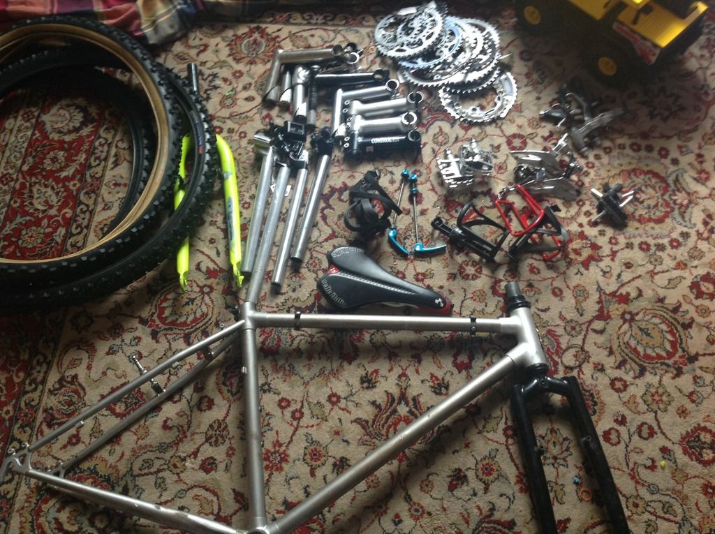

Had a dig out of one box and managed to get some pics :)
still got a rake more of tyres :shock: and parts in boxes, not sure but think I'm heading towards the modern route as I like the idea of a modern bike after talking to a mate down the road :)
Any thoughts ?
I think you are in the wrong place for opinions on retro or modern. That said, I've got my feet in both camps. I've a few retro bikes in the collection, a few of which I'll not part with. They are great to ride a d look at, and certainly don't look as generic as current bikes do. That said, there is nothing wrong with modern bikes in terms of capability. I think a lot could be said about clever marketing trying to sell you the next best idea, but I certainly enjoy a modern bike on occasion. The biggest challenge will be to decide what wheel size you want. Good luck.
