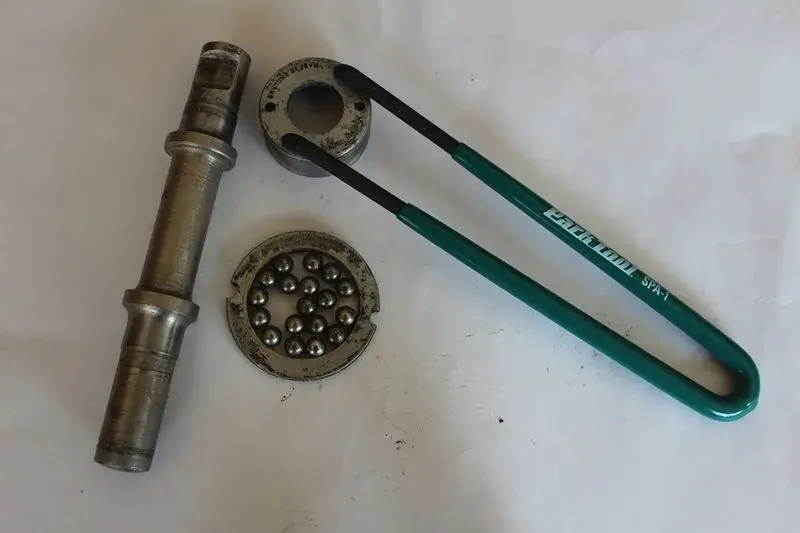

My first task was to clean the bottom bracket and cups. The non drive side cup loosened quite nicely with a pair of long nose pliers. However, I will need the correct tool to tighten up the cup on re-assembly. The tool required is the Park Tool SPA-1 as shown in the photo having purchased one recently.
Now back to the frame.....

Buying tools along the way as I needed them, removing the drive side cup was easier than expected. Having the right tools for job makes life so much easier along with knowing which way to undo it also helps. :-)
