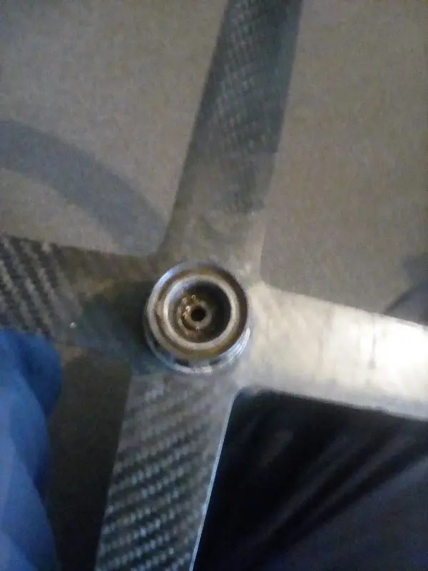

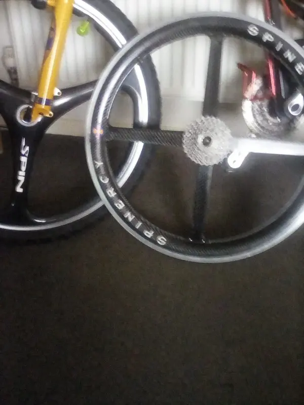

Can this rear wheel be salvaged?
I have a spare Front wheel if maybe any parts could be used?
I know there is a 35mms difference,but who knows.
Asking you guys as you all are alot more knowledgeable than myself

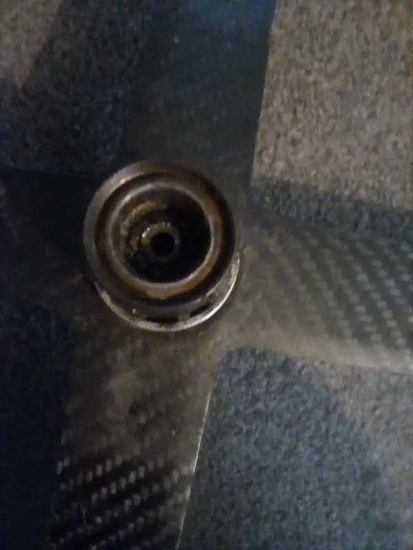

Looks like the axle has snapped, bearings have fallen out, what are my options?.
Or is the rear axle a two piece similar to rev x wheels with titanium axles?
I'm lost literally,well out of my depth.
Any help and advice greatly appreciated.

Ive no experience with these wheels but did a bit of online research and the only advice I could find on rear axle replacements was to have one made.

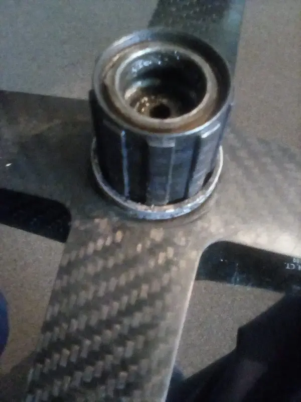

One thread suggested you could replace the freehub with an m750 xt or 105 version. I wonder if you could use an axle from the same hub as the donor freehub?

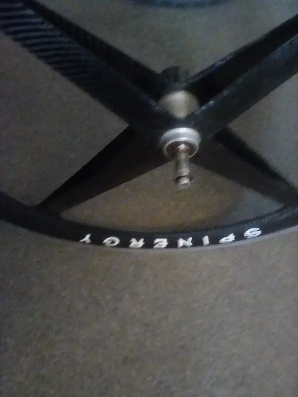

They are cup/come bearings right? What does the rest of the axle look like? I know when you step into the realms of sealed bearings things get a bit proprietary but cup and come are generally threaded and straight.
Hopefully someone will come along with the knowledge and solution you need.
Thanks Ian.
There is a pic of the rest of the axle included.
I also read you can simply use a Shimano freehub on these wheels, and perhaps the axle might work.
I believe they are pressfit bearings on the nds and ones in headset( style) for driveside. (Excuse my lack of terminology/knowledge).
Somebody suggested Danson67 could make one for me, he's good at this kind of thing.
Thanks Ian for your input.
Appreciated

Mine certainly just use a standard Shimano pattern freehub body, nothing weird.

How strange, I pm you,then check my flagged posts and voila, you have commented.
That's great,Thankyou, I'm struggling to find anything. I spoke with gacycles, sent two emails and not heard back, maybe there's my answer.
I think I need a replacement axle,and a new freehub put on. But there again I'm no expert( far,far from it if I'm honest).
Thanks mate
