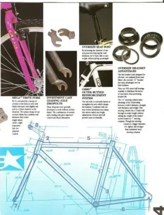

Sorry Mark, I have been meaning to scan the catalogue for ages. The actual description just says 'Lightweight Alloy, 300mm' for the seatpost. This could be the right page though. I think what it says is outside diameter is 33.0 and internal is 29.80.
Cheers Iwasgoodonce :) thats most helpfull :-)
Now can anyone tell me where i can buy a front mech and seatclamp for it at 33mm.............. it seems everyon only stocks 31.8mm or 34.? niether of which will be of use :-(
