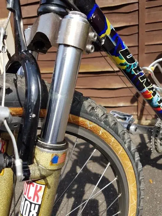

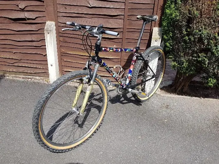

I'm trying to breathe some life into a 1992 Dynatech Quantum I've picked up. So I was amazed that upon re-inflating the forks they appeared to hold air! However very sticky and crap rebound. So I've flushed out the old oil, also had the wiper seals out, gave them all a good clean and smear of grease on upper seals and filled back up with 5wt Rockoil approx 35mm from the top on compression, pumped back up and seemed great (for a 25 year old fork).
However after a 10 mile ride, I've found that the rockoil is weeping up past the wiper seals (quite badly) and also have also lost a lot of air. Can anyone give me guidance as to whether this is normal (suspect not) and also any guides to replacing what I presume are lower seals in the legs that are probably shot and where I may source some in the UK?

Those forks shouldn't loose any oil at all. If they do, you need new main seals underneath the wipers. Are you sure, it is oil and not the grease you used for the wipers? (Just asking to be safe.) Those main seals then also leak air. But then the top caps may be doing so, too.

Cheers for that! I've seen pullers etc online that you need to seperate them... never thought of presurising to remove them! 100% damping oil is its bright green and runny, the grease is golden. Photos were pre ride, after the ride its running down the back legs of the fork! Okay so i figure best way to split them might be whilst fork fitted in situ on bike, wiper seals pryed up, circlips out and then with one person stood over the bike, another holding the fork legs and then another pumping them up with their face away from the fork. Next million dollar question is where to source a reasonably priced seal kit?! Anyone??
