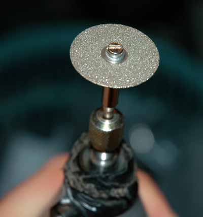

If you've not got any cable cutter but have a dremel (or other multitool) see if you have a diamond cut of disc ro buy one or a few of ebay for not too much. cuts both the outer types and the inners and leave an excellent finish
(quick pic search) and will look a bit like this
Save the grinding down of the ends to make them smooth or the pinching problem on brake outers.
Have a play, might be worth picking a cheap multitool up, as you can use it for other things as well ;)
