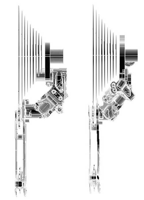

Sounds like the only thing you haven't swapped out is the rear derailleur. What is the chain line like? I'm not sure of the terminology here, but is the rear derailleur jockey wheel cage near verticle when viewed from the rear of the bicycle, or is it hanging at an angle? If the jockey wheel cage is angled too much the chain has to curve to get onto the cassette sprocket.
I hope that makes sense. :?[/url]
