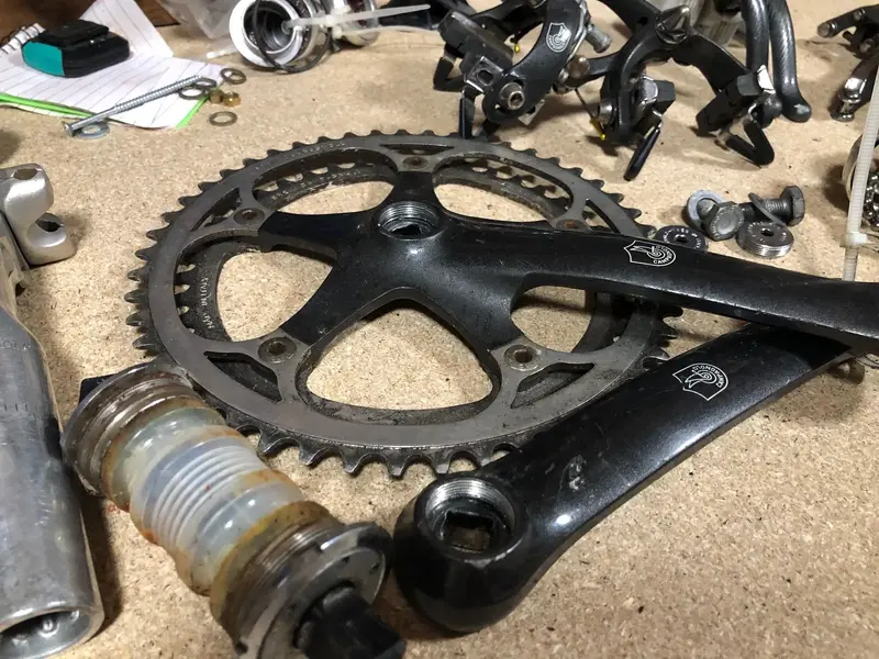

Hi peeps,
I've just bought a chorus graphite chainset from a forum member.
Need some guidance on which bottom bracket to source to go with it.
It's for a colnago super late 80s.
Thanks in advance.
Hi, Chorus of that generation uses 111mm spindle if your frame has a 68mm bottom bracket shell , you obviously need to find out if your frame is English or Italian thread etc .
Yes, it will be Italian. The Centaur 111mm BB is rather good, you can dismantle it and fit new bearing cartridges.
