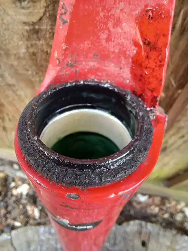

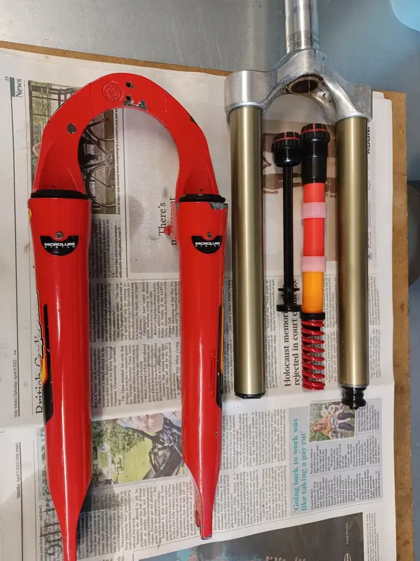

Just taken a 1999 Manitou Spyder R apart @jimwise68 and no apparent knack to it. Used a Bondhus 16468 6mm hex key to get at the bolts and they undid with very little effort.

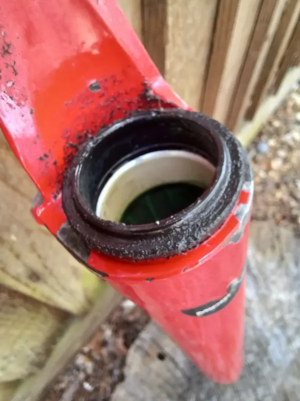

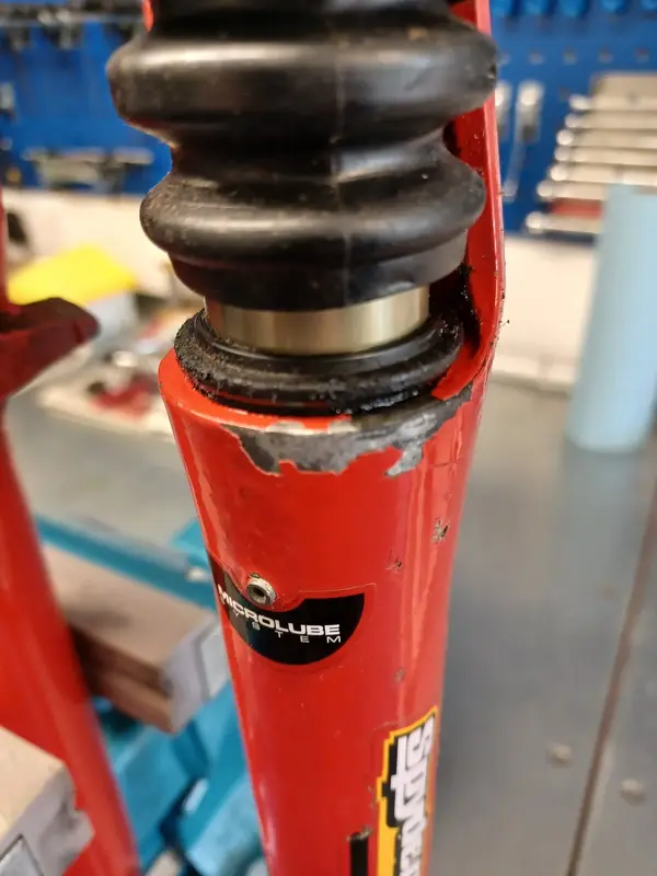

Like you, the insides were in remarkably good condition however the forks could benefit from a new set of seals.
Any ideas on where to get them? The stanchions are 28.6mm.
Cheers, Richard
