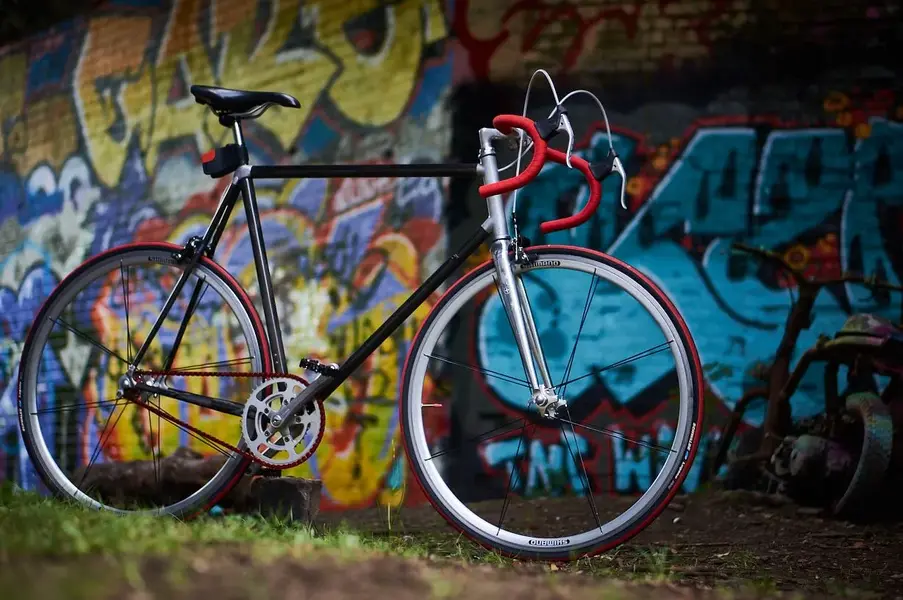

My new city hack :D:

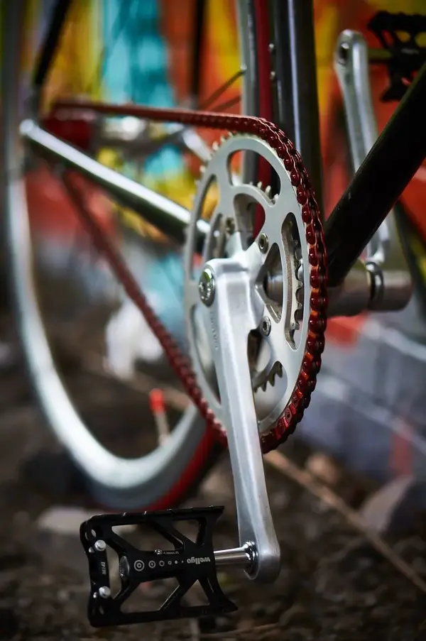

I finally managed to get together all the bits for my Vitus FCK9 singlespeed conversion, and I reckon its gone pretty well! The chain is a little crackly sometimes, which I guess is a tension/alignment issue. One that I'll have to live with when the dropouts are almost vertical... Unless i get one of those ugly tensioners :?
Total cost of the build was about £250 (a fair few of the parts came from free donor bikes)
Full details are below, what do people think?
I can't offer any advice regarding carbon fibre repairs, but that chain does look bloody tight, and thus could be a major contributing factor to the fracture, or delamination, or whatever it is.
Unlikely to be the chain tension.
I've cut open a crash damaged 979 so I can tell you how it's made. The lugs are a loose fit inside the tubes for most of the length. There's about 0.5mm gap all the way round for adhesive. The 979 tubes have about 1.6mm wall thickness and carbon ones are going to be about the same because they didn't really understand what they were doing. So I'm guessing they bonded them up with the lugs and tubes jigged to maintain that gap. You'll need to apply some heat to get it apart, around 120-150 degrees c to break down the adhesive but no hotter or you'll damage the resin in the carbon tubes. Carefully file out the old adhesive, key the surfaces, degrease, jig it up and re bond it at room temperature. I was going to suggest Scotchweld 9323 which is what we use at work for bonding composites and is strong enough for mechanical testing. It's the same colour once cured as the adhesive in the 979 tube too, so might even be what was used originally.
I still maintain that no good thing can come from running a chain that tight, especially on a 'bonded' frame- Something is gonna give, and, at least in the short term, it is unlikely to be the chain.
I'm running single speed on vertical dropouts myself atm. I was hoping not to have to mess about with chain tensioners either, but imo it is the lesser evil..
I think it's really very unlikely. From mechanical testing I'd say you'd need about 40-50kN in tension or compression to break one of those tubes, which is about 4-5 tonnes. Shear force to twist a tube out the adhesive I wouldn't want to guess but it's orders of magnitude higher than you could ever get the chain tension. You might be able to break the bond with leg strength if you were really forcing down and pulling up hard enough but you'd need legs like Chris Hoy. Defective/old/failed adhesive and nothing more imo.
So would you care to comment on the chain tension, Jonny69? I'd be interested to know whether or not you think such tension to be altogether harmless, and, if not altogether harmless, where you think the stress from such an arrangement is likely to manifest?
Afaict from the pics there is no hint of a gravity induced catenary arch on that chain. The only way to get a chain that tight that I know of is to take out the last (half) link, rejoin the chain, get it 'round the chainwheel and sprocket, and then force the wheel axle into the vertical dropouts against the chain tension. I don't know how anybody could do this and remain unconcerned by the resultant creaking and grumbling- the unmistakeable 'feel' of a machine in bad adjustment? ...and all those vibrations are passed on to the frame.
I'm not saying that "the chain broke the frame" in a simple cause and effect way, but for my money it sure isn't helping it to remain intact?
In an effort to end this pointless squabbling, let me offer my actual experience of how tight the chain is.
It's tight, that's obvious from the pictures. The order of the assembly is indeed to set the chain length, wrap it around the chain rings and the push the wheel into the dropouts, something which I do with the weight of the bike(ie, about 10kg maximum) The result is a chain which deflects 1-2cm when pressed in the centre of the chain with one finger at its tightest point on the chain rings, which is what was recommended by guides I've seen online.
Now the real problem comes with my weight on the bike. The wheel isn't fully into the dropout when properly tensioned, so I'm relying on my titanium skewers (which I bolt together, rather then being QRs) to hold the wheel in place. It's happened a couple of times that the wheel has moved in the dropouts when I've gone over potholes, and the result of course will be that the chain tension changes, potentially getting tighter.
However, given my knowledge of basic physics, it would surprise me if two halves of a chain under tension, with a chainstay between then under compression, could cause any significant force at almost 90degrees to a tube that lies completely outside the region of force transfer. My chain tension is by no means a good situation, and when the frame is back in shape I'll be trying various different setups, unfortunately I only had a week or two of riding before this happened
