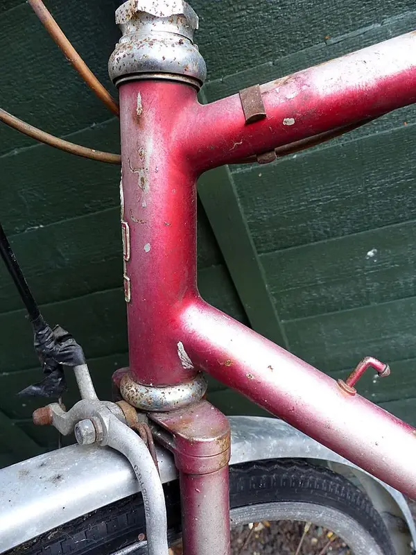

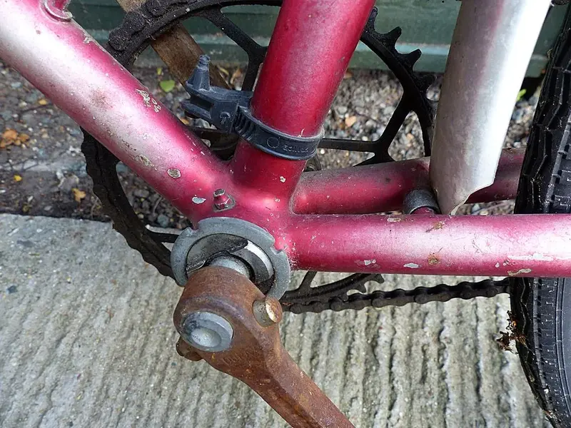

Please see my earlier thread "New member from Essex" (pre posting images) for more information.
I am particularly interested in the Frame /Fork combination, as probably everything else is newer (1960,s)?

From memory only, the first price CB post war was Jubilee model bronze welded.
The bottom bracket cup and lock ring look like a Ralaeigh 26 TPI, I wouls expect 24 threads per inch.
Keith
Hello Keith,
I have already viewed the "Jubilee" model on the V.C.C. on-line library catalogue and there are lot more features that my bike does not have, than those it does. Namely, no Brake cable stops under top tube, no gear lever boss on down tube,
no CB special guide tube under bracket for exposed gear cable, no adjuster stop on right hand chain stay, no oval section fork blades, no 27" wheels and no chrome fork crown.
Sorry, but many thanks for your help
Colin.

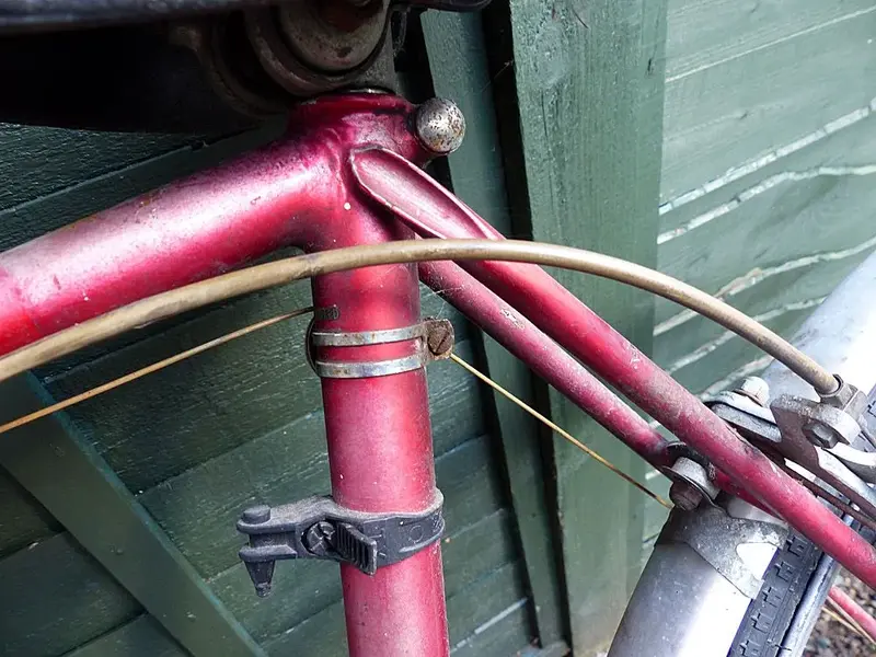

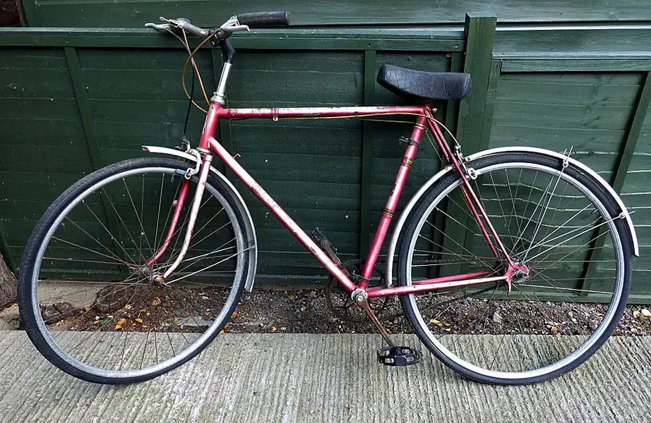

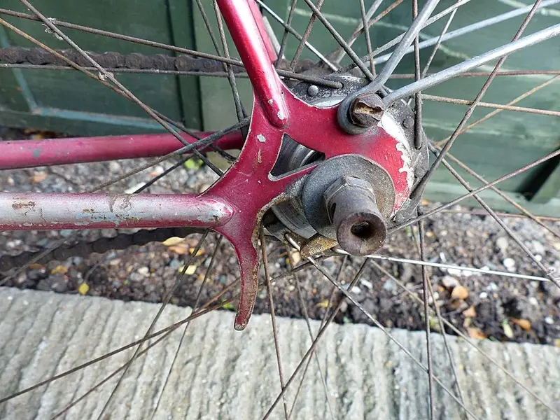

A few more images to keep the pot boiling and if anyone needs particular images, I will be very happy to oblige

The hub gear should have a date on the shell.
Your frame would be a typical general purpose and club rider's bike from early post war. Probably had a front brake and fixed wheel. Catalogues were just an indication, not law.
In those days my bike was my sole method of transport.
The conloy rims seem to have had little use, as the brake blocks used to carve grooves in them.
Keith
Conloy or constrictor rims very desirable Colin! Bicycles could be ordered with any spec at the time. Pictures were just a guide. Looks like a good project. Think late 40s. Are the wheels 26"? Any numbers on the rear dropouts?
Simon

What front hub have you got Colin? Any makers name on there?
