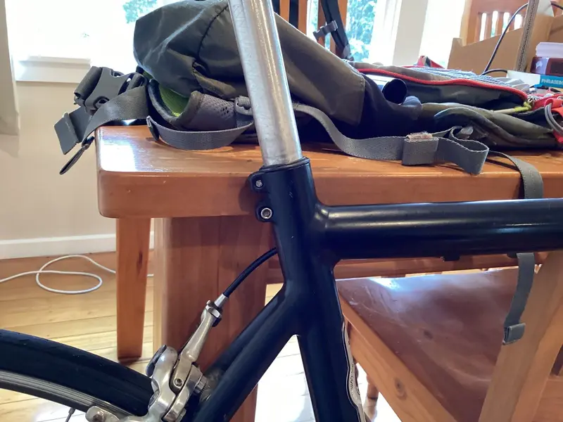

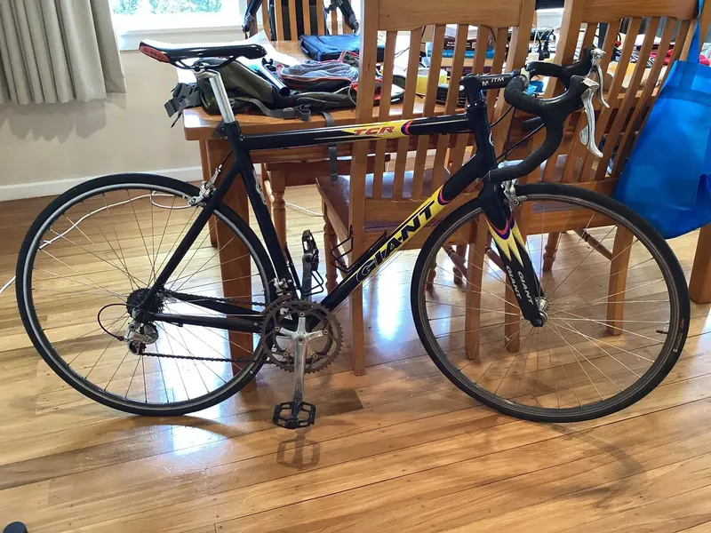

Hi guys,
I picked up a Giant TCR a few days ago and am trying to figure out what year it is. Photos below, with key details by my reckoning being an integrated double seatpost clamp, seat tube at the clamp machined with 4 notches to hold a rubber weather-proofing sleeve, seat tube forming to make room for the rear wheel, no back brake internal cable routing, and an Once logo machined into the head tube. Came with DA 7700 to narrow it down to about two decades 😖
What do y’all reckon? I haven’t been able to find anything with this paint job online yet.
Stephen
Identical to the one I had. I bought it 2003 as a 40th present to myself. So I would say 2002/3.
At that point the first carbon tcrs were being launched
Just to add, it was one of the finest riding bikes I had.
And be careful with those seat pin clamp bolts. The allen key heads broke off both of them, meaning patient removal of headless bolts

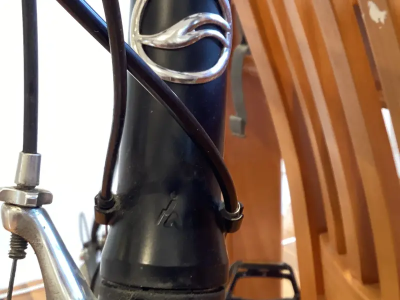

Awesome - thank you! Do you know what the headtube logo signified? Or was it just that anything with the Once paint job had that detail too?
Just the once logo as once rode their bikes a la joseba beloki and his 2002 tdf crash.
The frame you have was their top model pre carbon.
I had red bar tape and red wall tyres to pick out the red bits which looked good back then, coloured tyres are a bit unfashionable now
2002 TCR Team frameset with 7700 9spd Dura Ace groupset.
