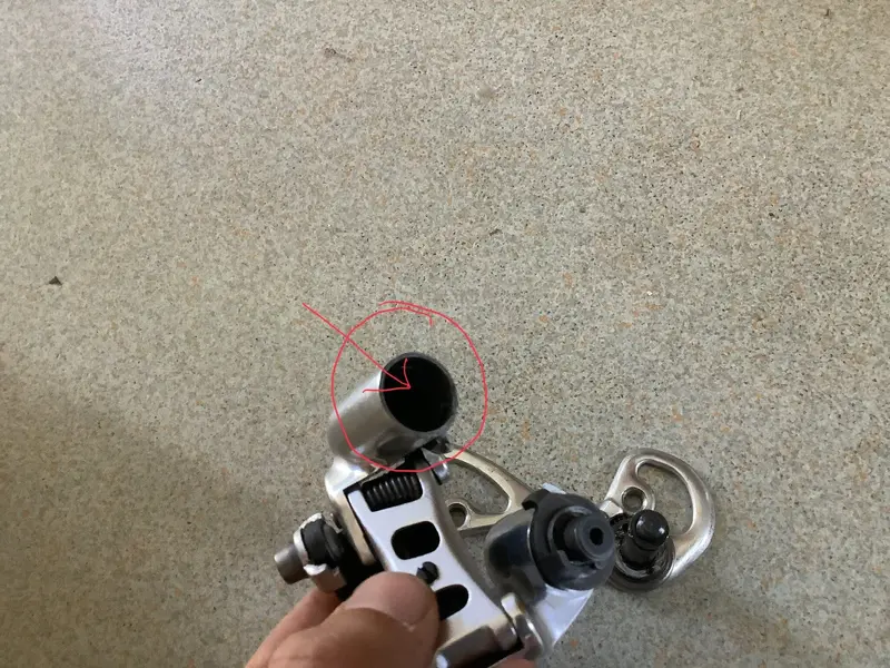

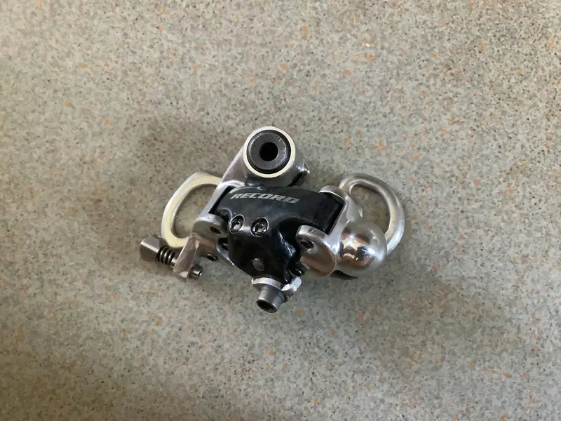

Hi, needing help I want to put this derailleur back to working order, however, there’s an issue. It seems to be missing a washer/spacer/seal (shown on photo where it is usually located). Without this part the pivot bolt that holds the cage in place has play as there is obviously space in between the body and the jockey wheel cage. I‘ve searched for spare parts incase it was possible to buy; it doesn’t seem to be. I’ve had similar problems locating shimano derailleur spare parts. Here I’m stuck. If anyone has the same derailleur to check 100% that something should be here; that would be great! Any ideas on locating a replacement would 2 :)

Which version is it? Looks like 9 speed? The manuals are all available in the gallery section, they should give you the spare part number
It’s 10 speed, I‘ve already found the diagram of the derailleur through the campy website, they list all documentation, diagrams etc….unfortunately it isn’t listed as a spare part to be purchased, infact the diagrams do no show the seals even if they are there.
