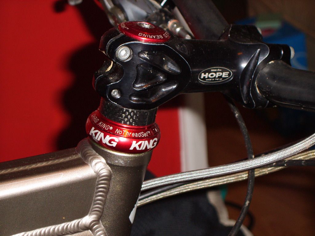

If you want the best out their , it has to be a Chris King Headset , which , I must admit , my original thought was ' :shock: Jesus, HOW MUCH !! ' :D , but now having actually owned one for well over 4 years , it was worth every penny :)
I've never had to touch it 8) , plus all the 'Chris King' headset carry a 10 year guarantee, which has to say something about the quality :)
The 'Chris King' headsets are available in loads of colours , and configurations , Threadless and threaded versions too.
All the individual parts of the headset are readily available , should you ever break anything.
A big plus side for me is they look beautiful to boot :)
Major down side however, is affording to buy enough of them for all my bikes :facepalm: :D
