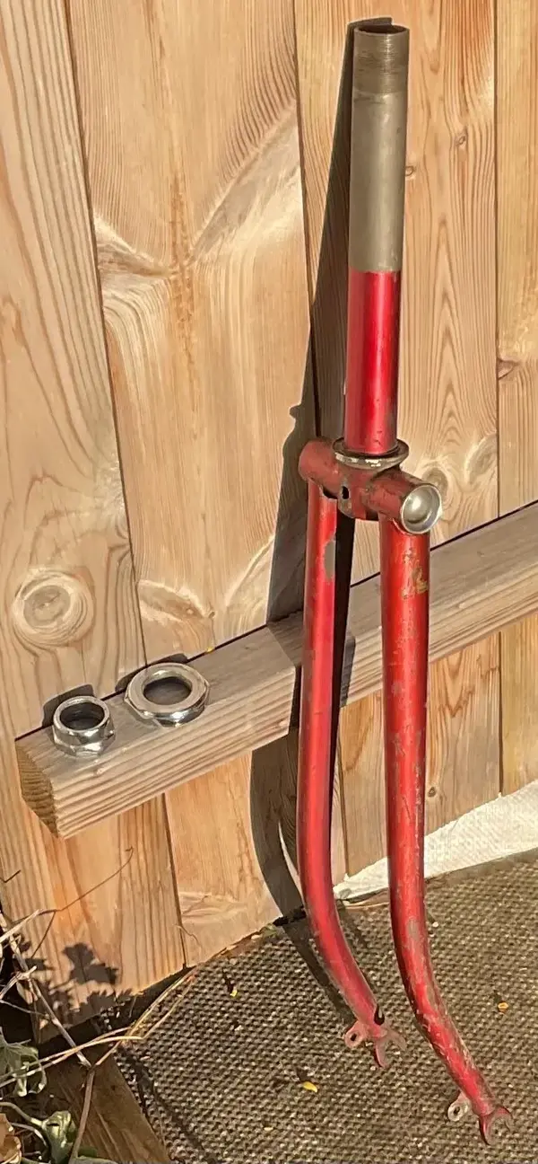

Hi there, I broke up a Carlton Courette about 5 years ago, bike was dated 1979/1980.
I disposed of the frame & forks however I kept a few of the components including the chrome cup and locknut and ball-bearings. See attached pic.
I think it is 26 TPI. I tried screwing it on to a 1960 Raleigh Trent fork (see pic) and it screwed straight on.
Wondering if this is any use to you? (£5 inclusive of postage)
