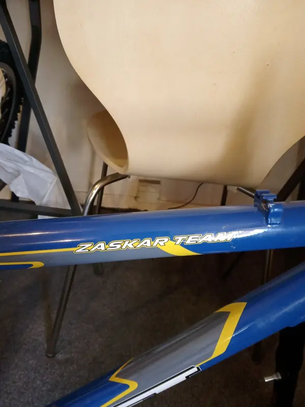

Bit stuck got blue zaskar frame cheap bit tired and troublesome.

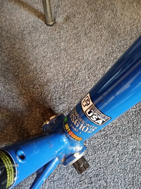

Need to find out what tell tale signs of exact year ?
And need desperately to sort out headset and BB for square taper cranks .

BB length follows the cranks. The only thing you need to check is the shell size, 68 or 73mm (IIRC it's 73 but check with a ruler).
Headset is 1 1/8".
Headset is 1 1/8".

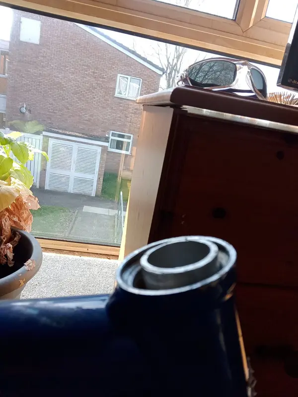

Got weird fully integrated design where the bearings roll on the frame ( I think they're called cartridge bearings )
Maybe it's never than 2003 ?
Any ideas about headsets for the 2010s era ?

Stick a couple of photos up of the bike and the headset/headtube if you can. It might be a semi integrated headset with the race fitted into the headtube so that it looks like its actually part of the headtube. Photo's will help to decide though.
Hi 🌈
The photos. I'll send one of whole frame in a sec .
