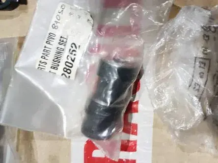

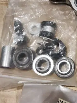

I found a few pics on my phone. Top hats still in packet and a group shot including the bearings. I've forgotten the name/type but they aren't standard sealed ones, the centres can pivot/move and sit proud of the outer casing.

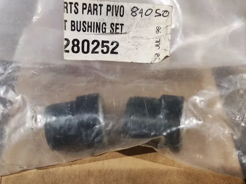

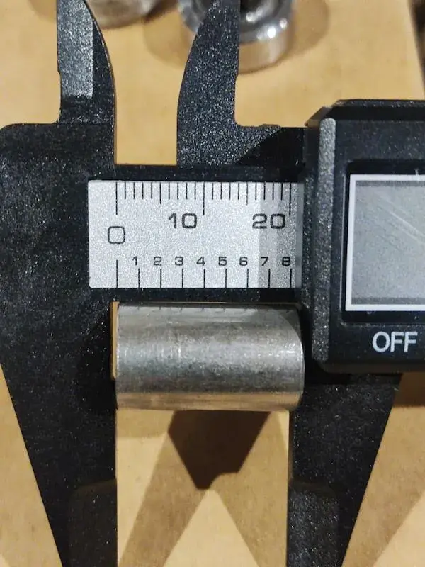

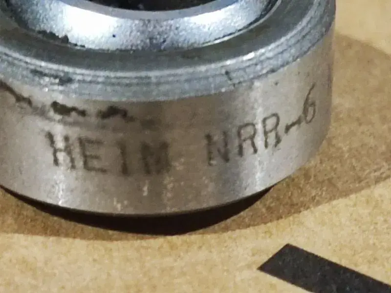

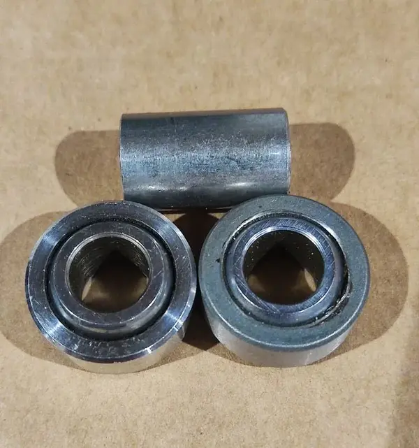

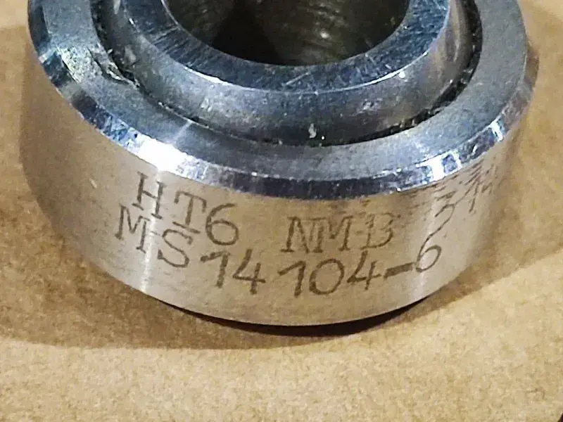

Sorry for the delay, been a hectic week for various reasons. I've grabbed some pics of the main pivot bearings I have currently out of a frame, including what I hope are useful shots of measurements and markings that might indicate the part number of the bearings and spacer size. My callipers aren't working so manual size indication only, and they wouldn't fit inside the bearing or spacer so I can't give an accurate inner diameter.
Better pic of top hat bushings too, which I guess I'd be willing to part with.
Hope it's useful.

That is a spherical plain bearing. Looks like chrome / ptfe. I just ordered some from McGill Motorsport for my bike.
You need the ball width, cage width, bore id and cage of to order some. There are metric and imperial versions.
Hope it's useful.
thankyou thats great info
