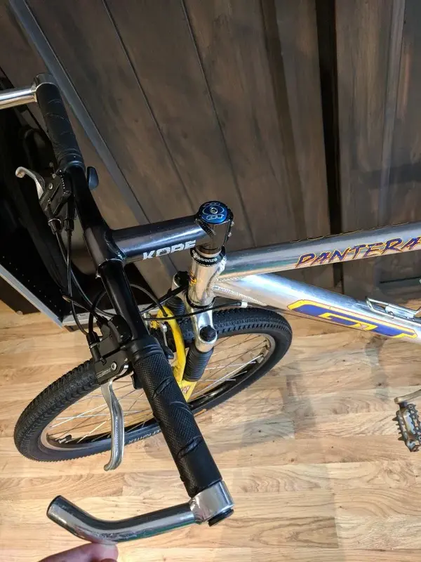

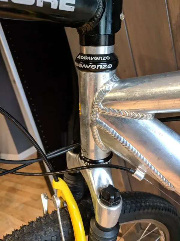

So I got the new headset in place, success! No more play in the headset! The crown race on this headset is split, so it fit on the fork with fingers, but stays tight.
The whole replacement took about 30 minutes start to finish. Most of the time I was trying to figure out how to use my guitar stand as a temporary bike stand. Removing the old cups took about 30 seconds, and installing the new cups took about 2 minutes. Unfortunately I made what I would call an amateur mistake (and I am an amateur after all). I did not line up the cups so the text printed on them look even from side to side before I pressed them into the frame. No matter, this is a cheap headset, and I bought tools along with it so I had to go cheap. Next season I can always upgrade to the more expensive Chris King which seems to be highly favored here, and I'll already have the tools to do it.
I did want to talk about the bikehand headset press. Unfortunately you sort of need 3 hands to operate it. 1 hand to hold an adjustable wrench at the very bottom, and 2 hands to turn the top 2 handles. I ended up holding the wrench with one hand, and twisting the top two handles with my other hand from the center, losing lots of leverage. Probably not a bad thing, because it forces me to move slower, but I would have liked the extra leverage so I could feel if i was forcing anything when I should be backing off.
I recall seeing videos of the park tool where you only put hands on the top levers. So for anyone considering this, just be aware. No problems though, worth paying less than 70 bucks for a tool that otherwise costs more than 150. Next time around I'll have a proper bike stand, but this time around I really wanted to have a headset press.
