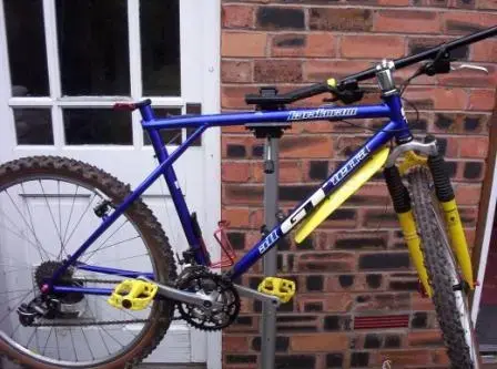

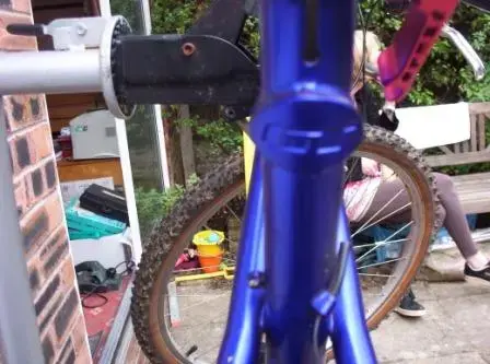

Guys, Can someone help me out with a picture or explaination of how the rear brake hanger works? I'm looking at a blue Karakoram with an LX groupo throughout. The cable comes out of the groove tube and through a braze on on the side of the down tube. Am I missing something? This guide is neither lipped or slotted, so how does it work?
Thanks in advance.
the one that guides the brake cable round the seattube? it literally guides the cable, it has no stop function
The more I look at it the odder it looks. I think now that the front mech guide on the opposite side looks weird too. I'm wondering if they are guiding the correct cable? I'm still no further on with the rear cable stop either.
I thought the rear brake had no stop - using canti's, it wasnt needed.
The cable is just steered down at the cantilevers...

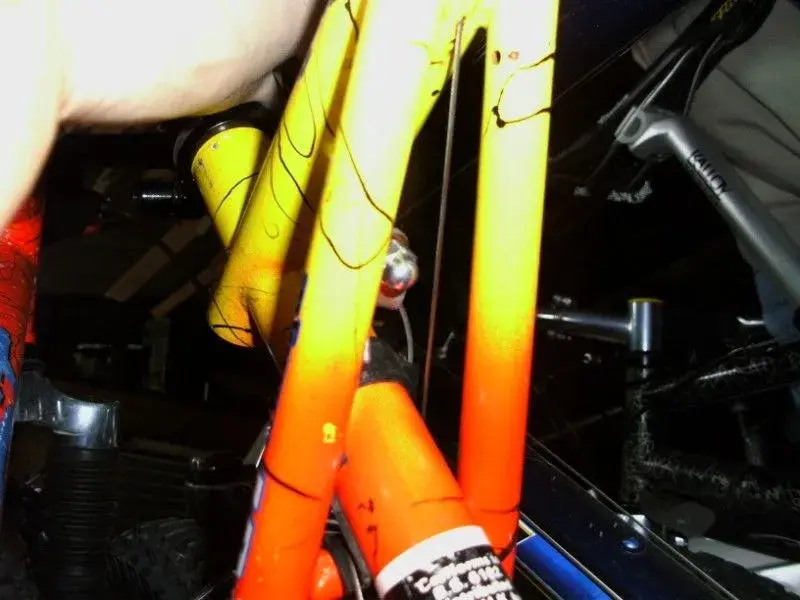

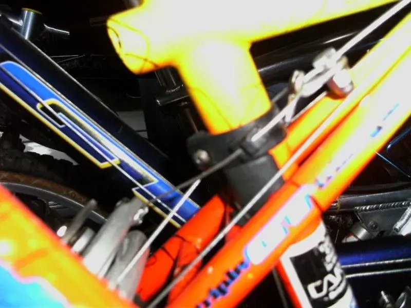

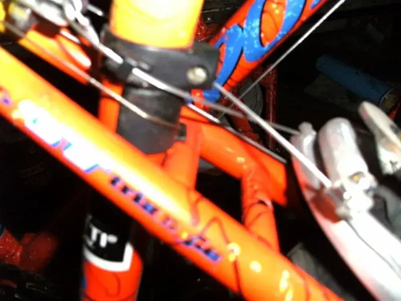

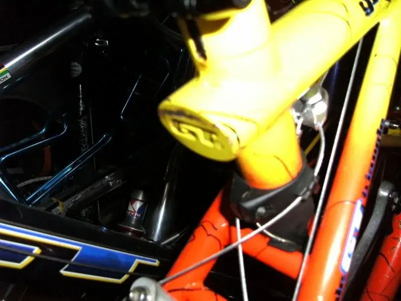

Ive taken sum photos of what your after, that is if it were u brake

Thanks Matt. You're a gent! This one is slightly different. How long did GT persist with the U brake. I bet they are mighty powerful and less prone to clogging on the seat stays?
