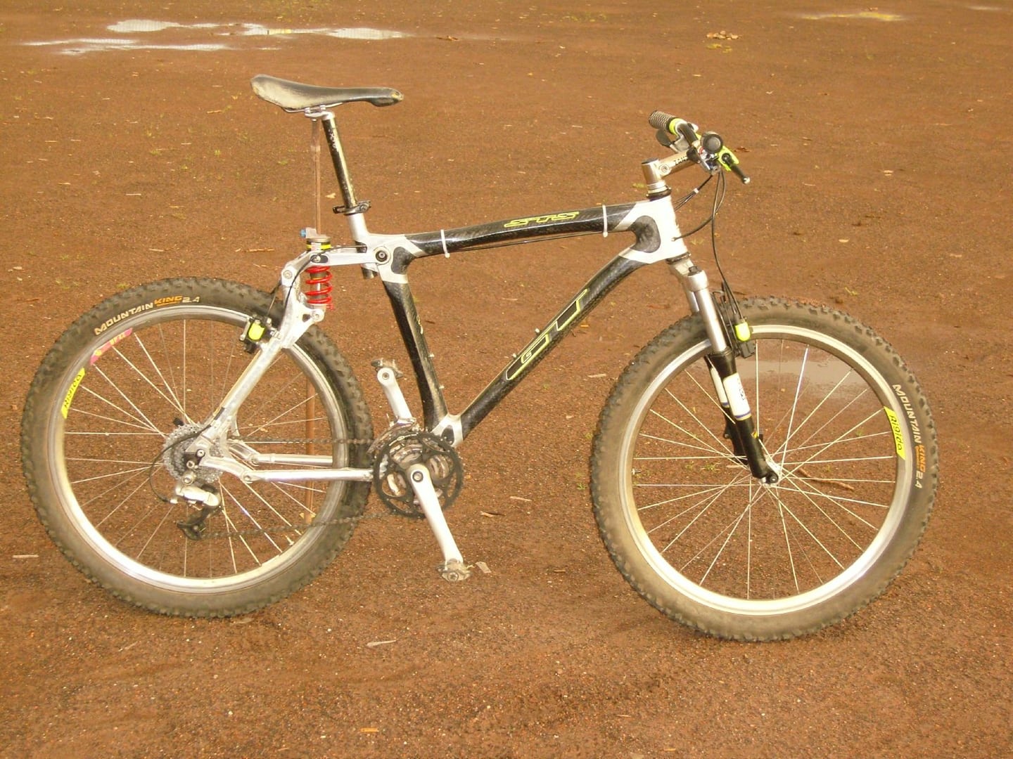

This bike is a GT LTS Thermoplastic. Not a GT STS. The difference between these two is in the linkage. The LTS has Ti linkage and the STS has alloy. The STS has a CNCed rear brace as well.
I had learned from my experience with my STS and eventually decided to thoroughly do this project. First I wanted to make sure that the suspension was working properly. I found a NOS rear Shock in the US and treated the frame to a new shock. The Pace RC36 Pro Class I had laying around in the shed was send to JustBackDated and they came back like new.

The cables of this frame go through the frame via a small tube. In the past somebody thought it was a good idea to loose the extra weight of this tube and bin that tube. During storage some of the cables 'fell' in the frame which left me three days trying to get the cables through the right holes in the frame.
This is what the bike looks like now:
Today I had the first little spin on this dreambike. It immediately became clear that this is a better bike than the STS was back then. It took me a while to get used to the rear suspension though. You can clearly notice the rear suspension requires some energy compared to any hardtail. It isn't as nimble as thought it would be either. But when I was riding the bike for 10 minutes I was getting used to the feel and even managed to bunny hop a few times. During the ride confidence grew and loved the bike more with every kilometer.
I do wonder though... Does anyone happen to know how I can make my fork stiffer? Are there other springs available?
