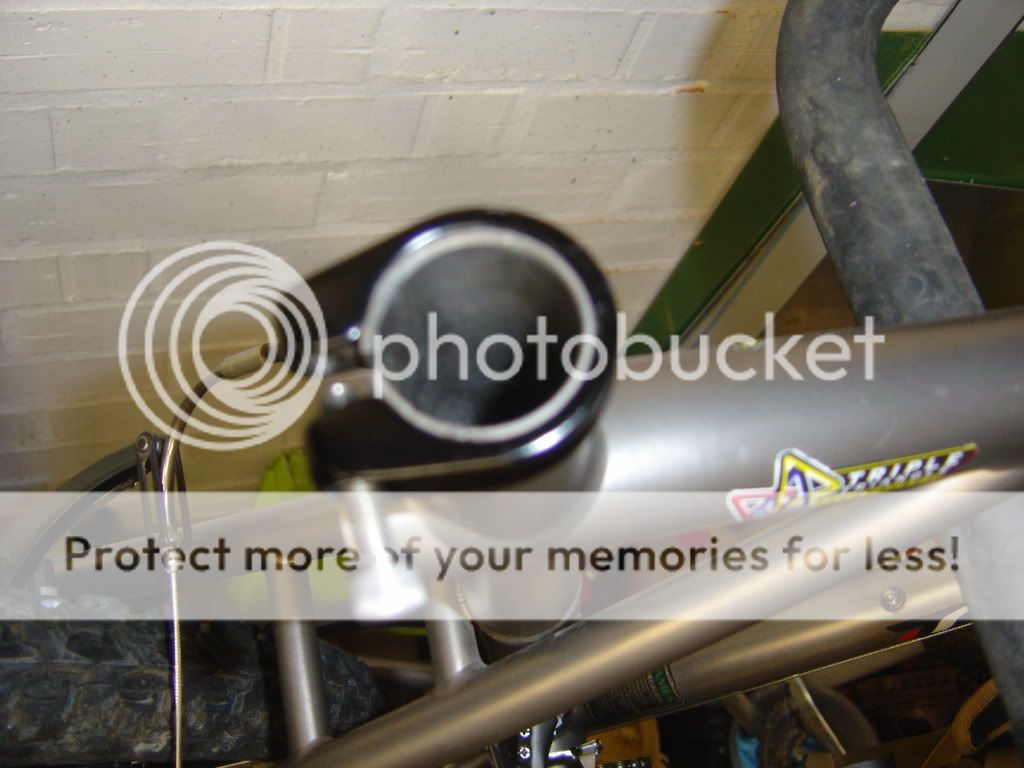

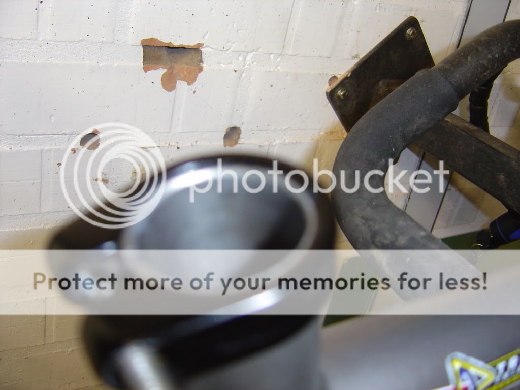

Hi RetroBikers !
Just have the same problem than daj...
As already discussed on FB with gm1230126, a seatpost in 27.2 flaps around too much and pinches the seat tube too much :(
I've purchased a USE shim post 27.2 to 27.8, and it doesn't work any more : I can't put more than 2-3 cm in the shim, as the seat tube was tapered !
I don't undarstand what the issue...
If someone have an advice !

The post above states the frames came in 27.2 and 27.4, have you tried a 27.4 post?
Hi mkone,
I don't have a 27.4 in stock to test... :evil:
When looking inside the seat tube, I saw that the seat tube seems to be reinforced on the triple triangle zone. But don't understand why it seems to be tapered...
Here, some pictures :
