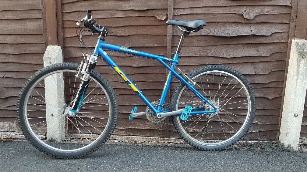

I've got a blue Bravado in my fleet, was mine from when I was in my mid teens and handed to my Mrs, think mine is 96 or 97 with full STX RC groupset, what year is yours? From looks of it be careful running such long forks, they will likely screw up the geometry/handling pretty bad, I'd go no more then 100mm or ideally 60-80mm if you can find some? Mine came with steel rigid forks but recently swapped out to Manitou 3s.

That’s a very nice Bravado in blue, looks like a 98 model with Reynolds 631 oversized tubing from what I can make out, from the serial number on mine it’s a 1997 starts with S7 where I believe “S” is the factory and “7” is 1997.

Looks lovely and clean! My bad on age of mine, it is indeed 98. If a bike could tell a story.. so I bought the Bravado as a frameset with bent mech hanger off my mate for £15.00 when I was a teen... straightened out the hanger... I then built it as a hack bike in my early 20s, only for it to get stolen out of my garage on the xmas eve, along with rest of my bikes!
I then spotted it out outside of a local McDonalds the new years eve, Police recovered it and handed it back... Now in my late 30s i've rebuilt bit to pretty much original spec/parts from the era and back how it should have been 20 years ago haha!
