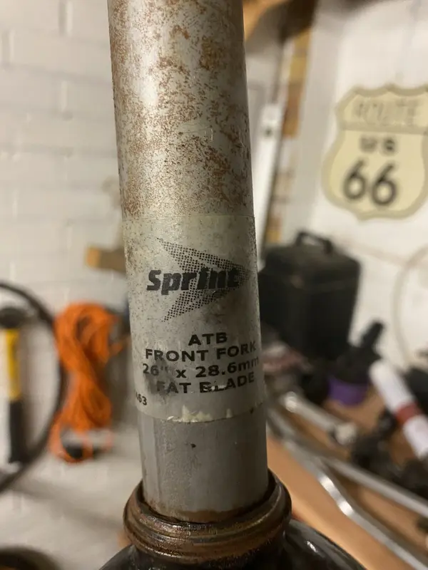

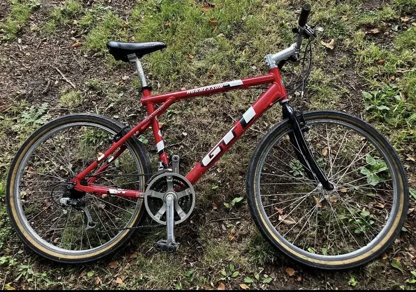

I’ve just picked this GT Aggressor up for the bargain price of £10. It’s a bit rough but that was kid of the plan as I got it so I can learn to strip and rebuild a bike myself instead of getting of paying a bike shop to do it all. The suspension front forks have been removed by original owner for some reason.
So far I have managed to completely disassemble it and get off the seizes drive side crank arm to remove the bottom bracket.

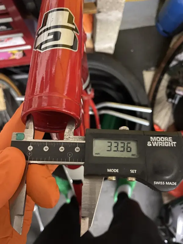

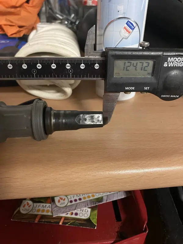

The BB measure 68x124 and the headset is 33mm . The free wheel hub is slipping and the wheel bearings are rough so could do with a rebuild.

If you do have a functioning 8-9-10spd hub back there -- ie if it's just the chain skipping, slowly evolving into an automatic transmission, and not a nasty old knackered hub -- the world is your oyster. Agree re: hollowtech style cranks, you can get em on Ali for as little as $33 US, including bb and chainring. Check out the microshift groupsets, wifey adores her 1x9, it was cheap and an easy install

Far as your headset is concerned. I don't think there's any such thing as a 33.36 head tube standard, sure it's not closer to 33.8? Odds are it takes a standard, plain old 1 1/8 aheadset. I ordered an FSA off Amazon for $25 US and ya know, it ain't half bad. Has those fancy new-fangled "ACB" thingies in there. What'll they think of next, eh.

Weak point I found was the wheel axles, but thankfully an easy replacement as its just a normal cup and cone loose bearing hub. Headset is a standard external 1-1/8" headset. Many brands make them, nukeproof, FSA, Cane Creek etc.

Front cranks - agreed on hollowtech II, easy to install and fine for various sizes based as uses plastic spaces for BB size / chainline

As said above, you've probably dodged a bullet by not needing to worry about the original suspension forks, they weren't good and we're heavy.

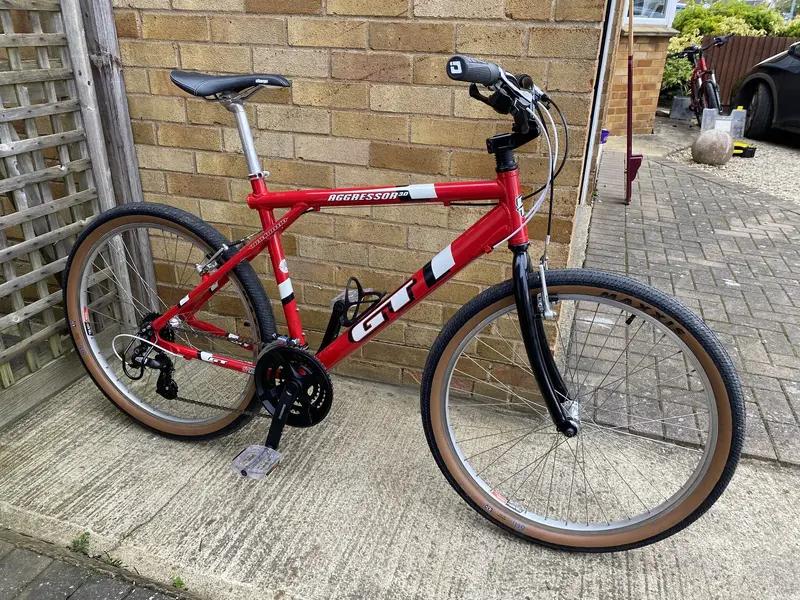

I forgot to take pictures along the way. Im
going to Amsterdam in June and then on to Assen to watch the Moto GP so decided to build it into a bit of a cruiser using new and used parts purchased from EBay .
I put a set of Fairdale low rise BMX bars on with a eBay top loader stem, ODI grips
, Charge spoon saddle, Maxxis DTH tyres , a mix of shimano gear bits . I’ve only been round the block so far but am really happy with the riding position . I have also got a beer rack for the front to go on also 🍻🍻🍻🍻🍻🍻🍻
