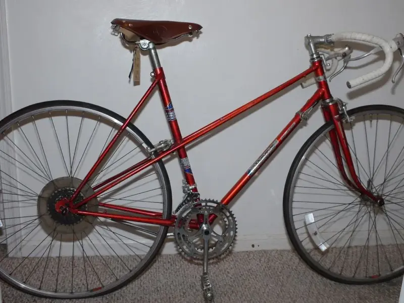

Today I worked on the original bottom bracket and the headset. The cotters came out before without any issues but the drive side cup won't budge so I left it and cleaning everything up from the adjustable side. Here's a picture of it with some of the parts fitted just to check things out. The rear derailleur and fenders aren't fitted in this picture though. I think the original cottered crank looks pretty nice with the setup.

This s my first French bike with the French bits, but I knew there were differences. I'll have to double check and make sure I was trying to turn it the proper direction.
hamster":exw9jul0 said:
I assume you know that the drive side has a left hand thread?
I was under the impression that some french bikes, especially earlier ones, were a right hand thread on both sides? May be wrong but I'm sure I read it somewhere. I take it there's no easy way to tell other than trying to undo it, and hopefully not keep tightening it instead?
