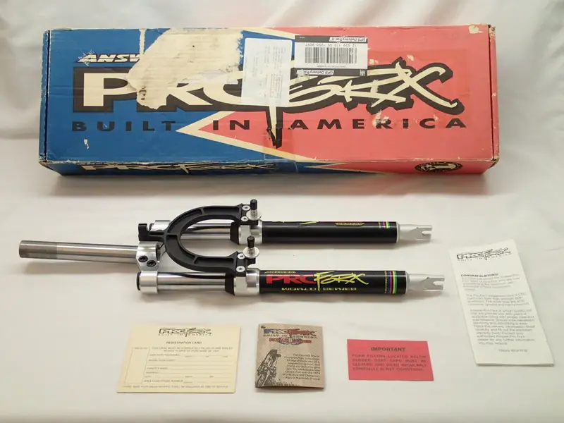

and moreover the Answer ProForx model, also just as a second line in their fork portfolio.
Is that an fork from an independent, most likely Taiwanese manufacturer?
Are they all a bit the same, just different variants, evolution levels and different co-branding?
Or was technology and name ProForx licensed to partners like Girvin and Answer? Which have produced that stuff than on their own?

They're all the same fork in reality.
The black ones, the whole dropout screws off instead of the flat bottom cap on these.
Also search in the BMX word, once I stopped using Girvin and used Answer it brings up a lot more, 20", 24" versions and again all the same, just less elastomer stack (and length) , they loose the spring.
