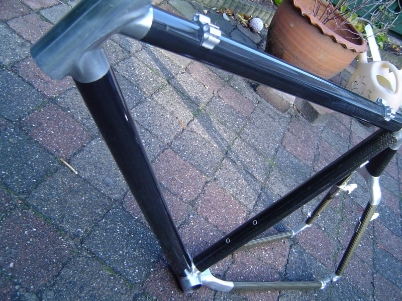

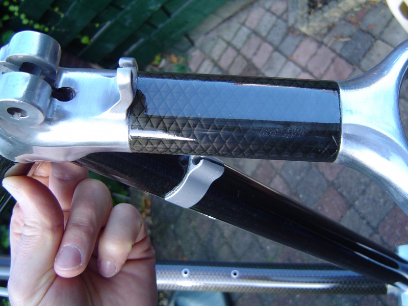

I like to reveal the he carbon tubes inserted in nice aluminium sockets.

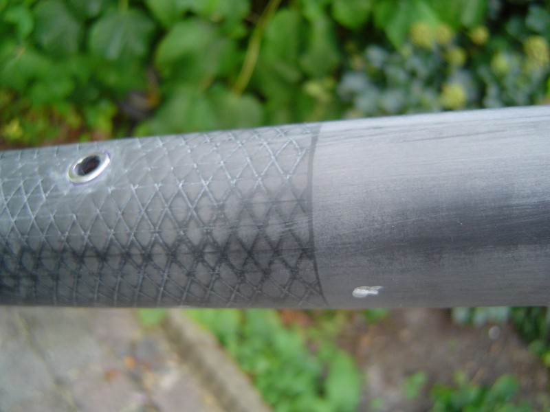

So I had to removed the paintwork and it took a lot of carefully grinding .
It revealed that the top and downtube are divided into different carbon designs wich was concealed by the paint.
I think the original tubes are a bit boring black without relief from fibres.
so they put some carbon relief on the second halves of the tubes(see picture nbr 2).
Nevertheless i still think it will look nice when the tubes are clearcoated...

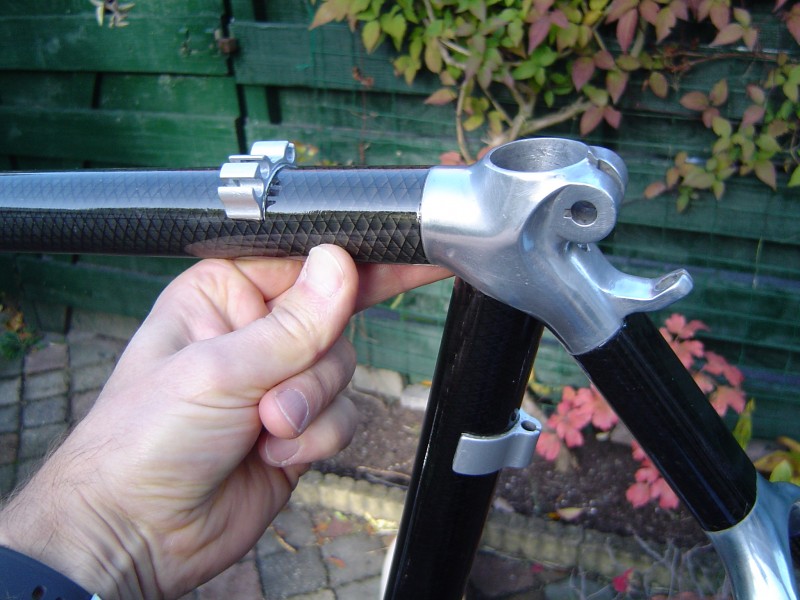

I like polished alumium,which ment I had to remove the paint and primer from the alu lugs also.
This was a hell of a job (Giant did a good job on this) I used heavy gear , like toilet drain cleaner for stripping the aluminium.
I tried paint striper which removed the paint but it didn not remove the etching primer on the alu.
A lot of polishing and cleaning later I used clear Alodine on the Aluminium .
I am now ready for the first clear coat on wich the decals will be placed.

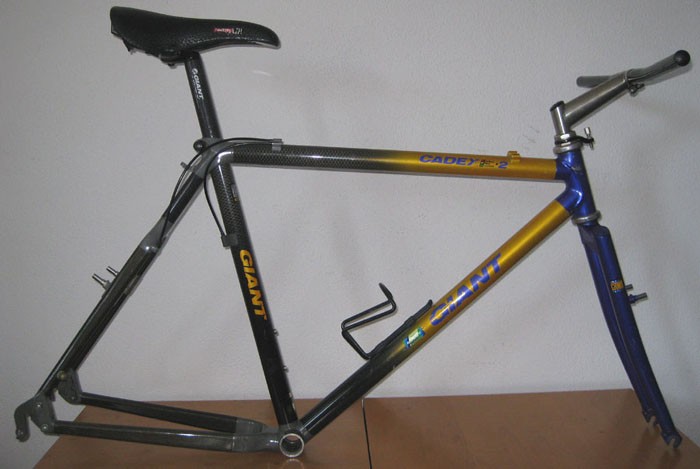

Here's the other frame i have bought , it will stay original.
The first layer of clear coat has been aplied. Its not superb and needs some rubbing but it's good enough for the decals.

Yes, great project ...and I must say that looks really good for some hobbying :) So you dared to use paintstripper and even more aggresive materials on a bonded carbon frame. Weren't you worried in advance?
Of course i did not touch the carbon or the epocast glue at any moment with the aggressive materials i used. It was taped and the remover was aplied with an brush. Anyway , i have been building surfboards in the eighties and learned that epoxy is realy though, and can stand a lot of aggressive shit .Don't worry.
