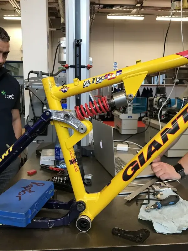

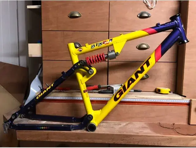

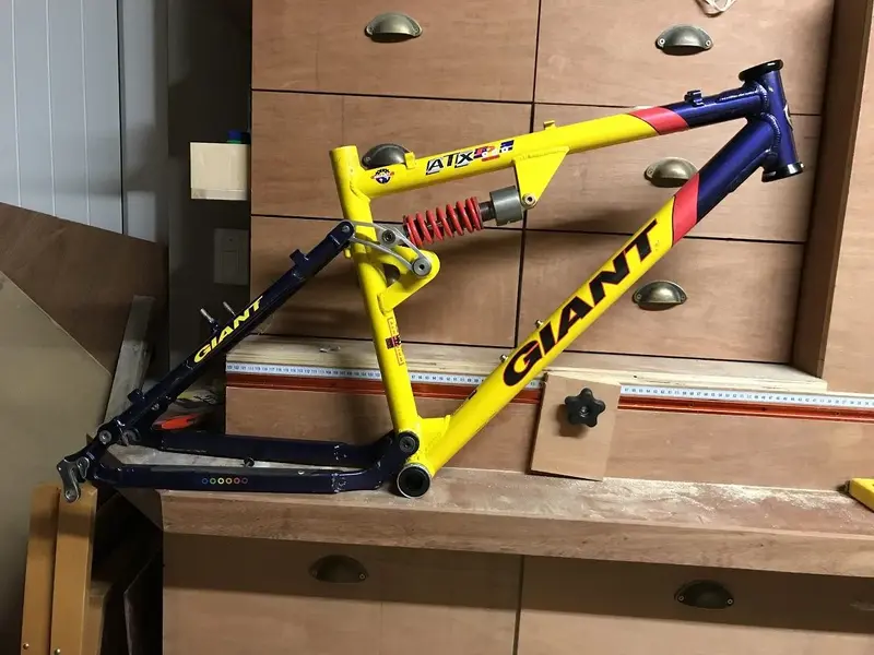

I made the new linkage plates today. These are the first version. I have 2 more variations to try. Still on the hunt for an ATX 970 from '98 or ATX 950 if there's any out there.
Project so far -

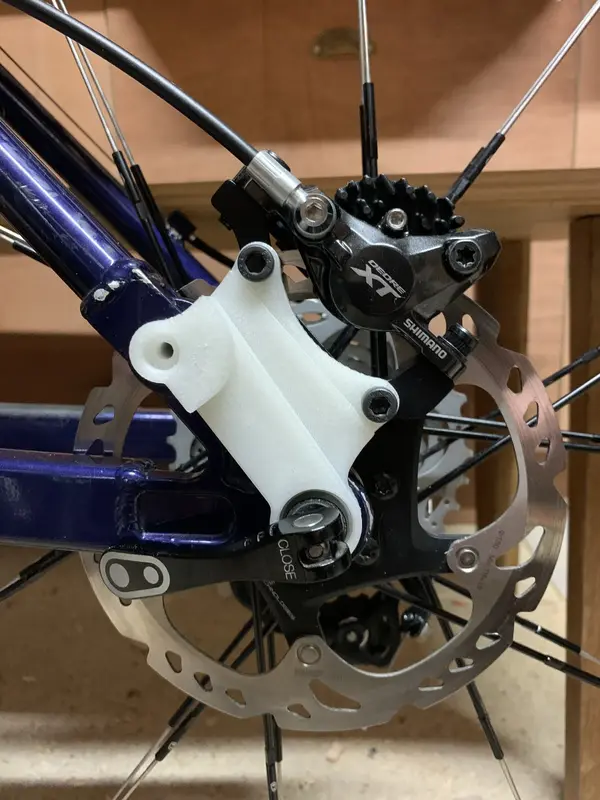

Another update on this project. I have waited long enough to try and source an alternative rear end so rather than wait any longer i decided to design a bracket that would hold the rear disc caliper. So far i just have it 3D printed and hope to get it CNC’d in the next couple of weeks.
Looking good!
