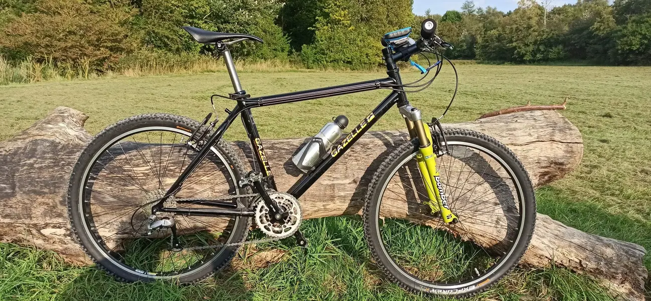

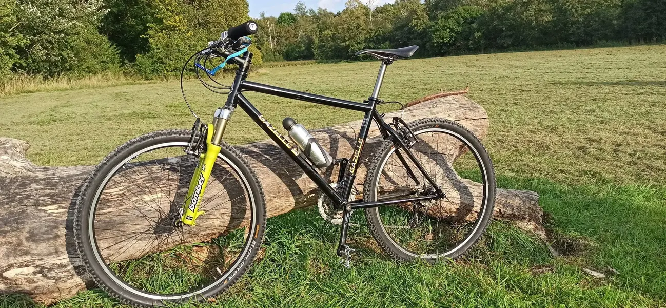

Frame Gazelle Titanium 1995 ( identical to Raleigh Titan ) with original black painting and decals.
Complete Titan frame. The structure is not time period correct.

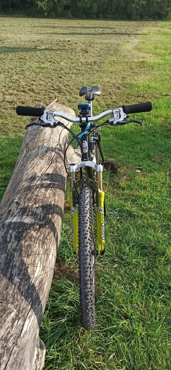

Upgraded to 9 speed XT RD m 750 + XT SL m 750
Fork: Bomber Z 4 air pressure 1998
Crank: LX Deore black
Seat Post : Use Sumo Titan
Saddle : Leather with Titan rails
Hub : Hügi DT Swiss 240 black
The bike is very comfortable and pleasant to ride; a fine frame, even if it is not world-famous.

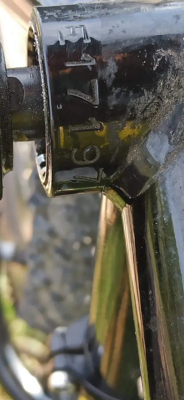

I thought my bike was just like you from 1994, but the serial number under the bottom bracket shows ,
that the bike was produced for the 1995 = E (see photo )
B = year 1992
C = year 1993
D = year 1994
E = year 1995
F = year 1996

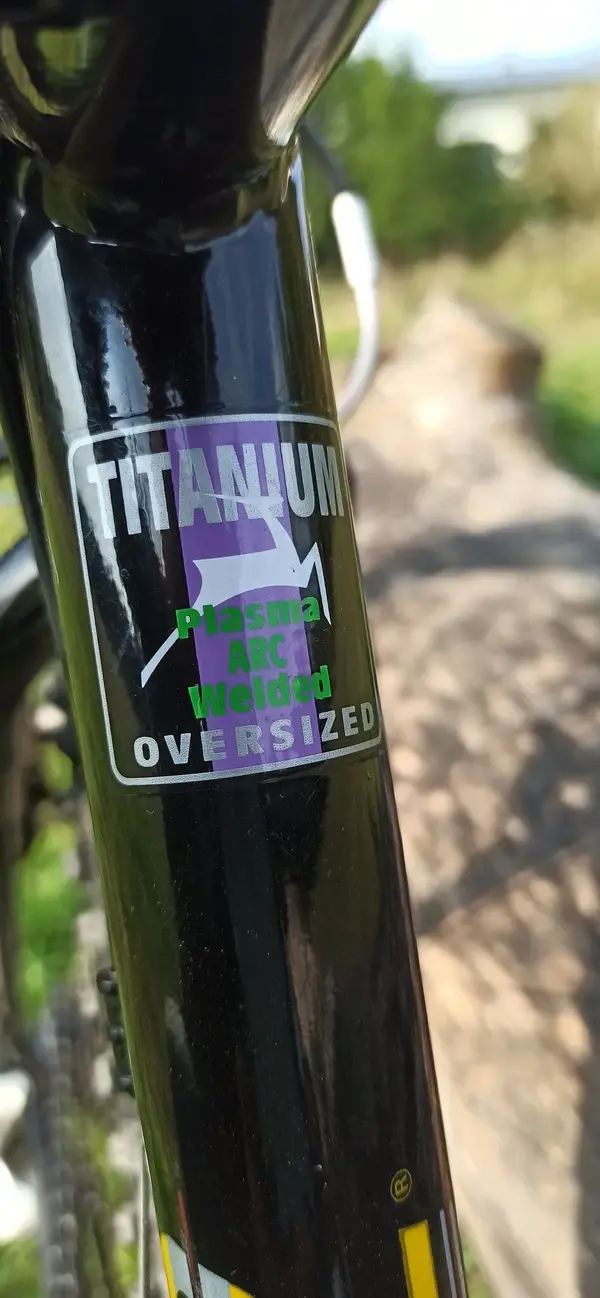

The Relaigh Titanium and Gazelle are the same Frames with a little difference on the rear bowden cable holder,
which is more delicate on the Gazelle frame and not quite as bulky as on the Raleigh
In 1995, Raleigh changed the dropouts of the welded titanium frames. Most of the old frames that were not sold came to Germany and were sold as now black powder coated frames and as Raleigh USA Design.
It was similar with the Gazelle Titanium frame.
My frame is identical to the first series of the Raleigh Titanium from 1993: frame triangle plasma-welded (therefore thick welds almost like aluminum) and rear end made manually with the "simple" dropouts (the later ones were milled out) and riveted Bowden cable holders on the top tube.
