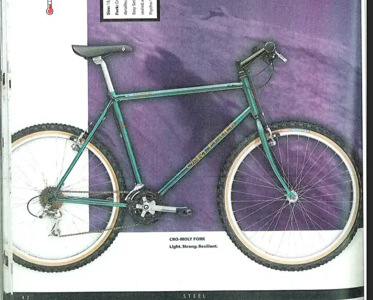

Sorry my description was pretty shit! It’s 1990s, 26” wheels, cantilever brakes, metalic green, looks like Shimano Group set
That looks like a steel frame in a larger size. Gary Fisher was one of the originators of mountain biking. They used to run heavy American cruiser bikes (Klunkers) with coaster brakes down mountains. They called the first race Repack because you had to remove the burnt grease form the overheated brake after each run. So that's a very early MTB with the parts available at the time. Quill stem, road (Touring?) triple driveline with 26" Cruiser size tires. Sort of a reverse hybrid. Gary Fisher was always a stickler for geometry. Don't be surprised if the bike just feels right when you ride it. Modern light weight Gravel racing tires in the correct size will breath some life into it. Many of them have the tan sidewalls now. Rene Herse Extralight slicks or knobbies would give surprising performance, but triple the cost of the bike. Schwalbe Billy Bonkers hit the weight target at a normal price point. Those brakes look like they predate the side pull MTB brakes. It may be very early. The leverage is different so watch for that if you get it.
The Marlin was the entry level model, but good enough to be ridden hard. The brand has provenance. Not scarce or valuable, but still a significant step in MTB evolution.

I had once a Gary Fisher Marlin from 96, bought the frame on ebay, and was thinking of using this for a kids-bike build as it was a small size with only 36 c-t-t height.
20201220_135112-jpg.1210670
Meanwhile it's sold again, same as I've bought it, for cheap money...
I have liked a lot the nice green color, but the quality of the lacquer was apparently not very reliable.

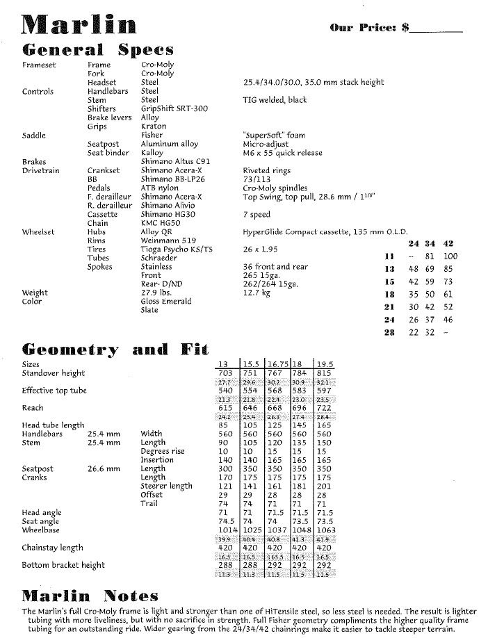

Also technically, the Marlin frame is solid but rather basic. At least already full CroMo, no Hi-Ten, but with plain tubing. The small frame had a weight slightly above 2Kg.
In particular the used components at the original spec Marlin had been all entry level. BB and wheel set had been rather weak.
The seat post had a strange 26.6mm size. Maybe also a sign that the used tubing wasn't very thin.
garry-fisher-marlin-1996-spec-jpg.1210874
No clue about your local prices for bikes like that. I wouldn't pay more than 100€ for a full bike in good condition.
