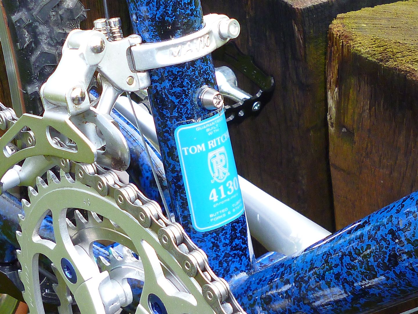

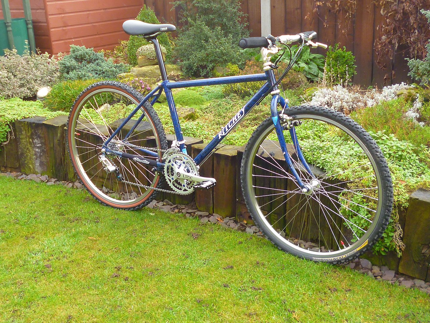

Lovely example of Tom Ritchey's first "production" frame. 1985 Vintage. Tig welded front end in Japan by Tange, fillet brazed rear, hand finished in the US.
I believe this was the first MTB to utilise Tig welding, have vertical 130mm rear drop outs, a Unicrown fork and a Splatter paint job.
The frame and fork are both DB Tange MTB specific 4130 and was designed in conjunction with Shimano for their MTB specific M 730 Group.
The Geometry was a move away from, the slack angles of old also, with much sharper steering and a more centrally based weight balance, than the previous offerings.

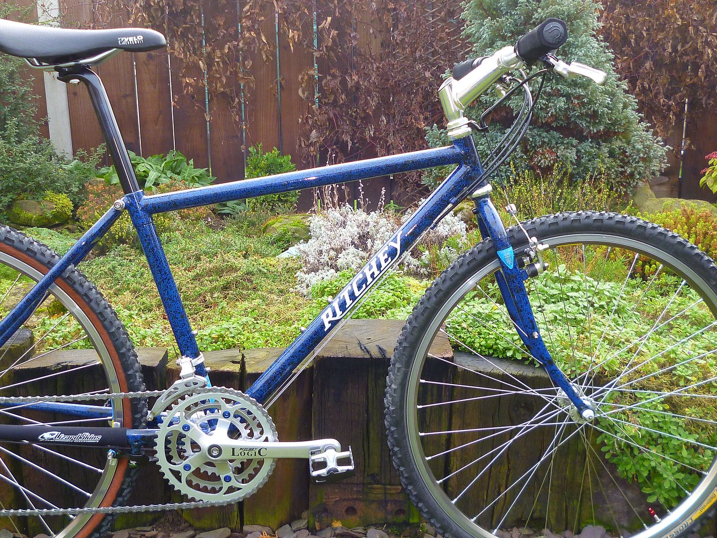

Some of my component choices are for function/weight rather than mid 80's specific. Although the Mavic mechs' are from 85, work really well and are extremely light also.
Went for DiaCompe brakes, as the Shimano U Brakes were awful and weighed a ton. I must have tried 10 plus stems and the original weighed 595g! The Zoom one weighes 223g. All up weight is 21.1 pounds, which is impressive, but the F&F are very light and it is a small size. The bar is an Original Rocky Mountain alloy.
The paint was passed it's best when I received it a year or two back and I pondered for months over a respray, but decided to carefully "touch up" the original paint, which has been very time consuming and tedious! :facepalm:
First I had to match/mix the paint with something tough, then carefully rubbed down the area where the paint had rubbed/chipped and then hand touched in, matching the original pattern. I then carefully used an Auto refinishing paint reviver compound, that is very gentle and removes a lot of the discolouration from the original paint and it has come up very bright now.

A lot of these frames had the U brake mounts removed and then Canti mounts brazed on the seat stays, but I have left the U brake mounts as this dates the frame and with the Dia Compe version installed, works really well and can lock the rear wheel at will.
The ride is extraordinary for a frame 28 years plus old and although these were production frames, they were still pricey BITD.

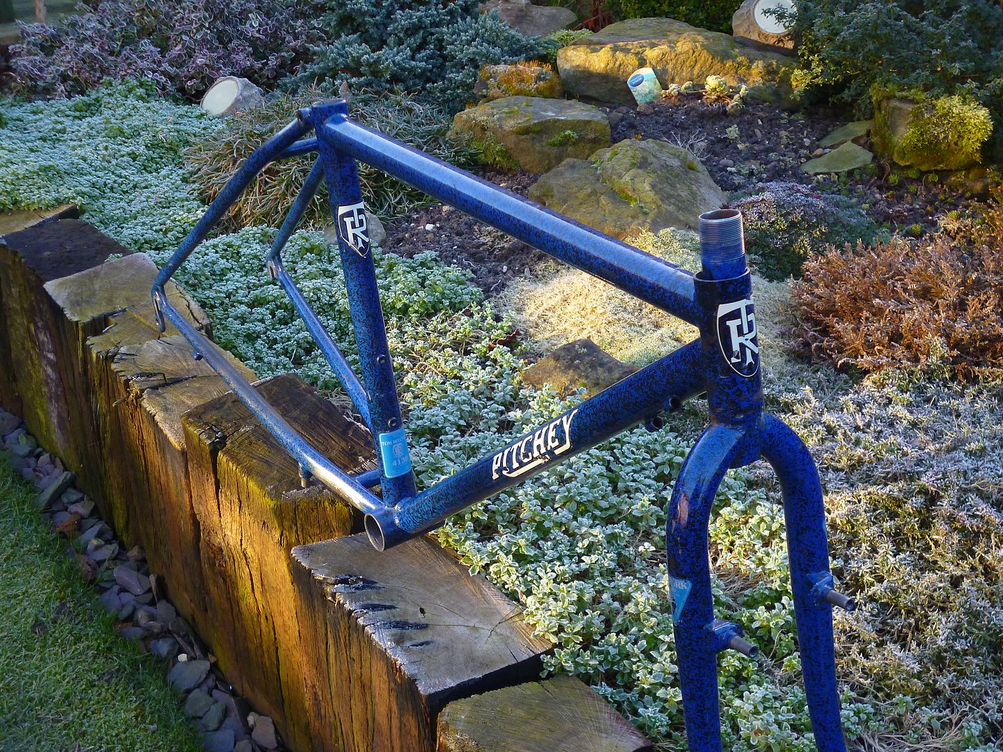

The frame has a double diamond stamp on the BB shell (one Diamond around another) with an ES within the Diamonds, I believe this indicated a development or special order frame, but may be wrong.

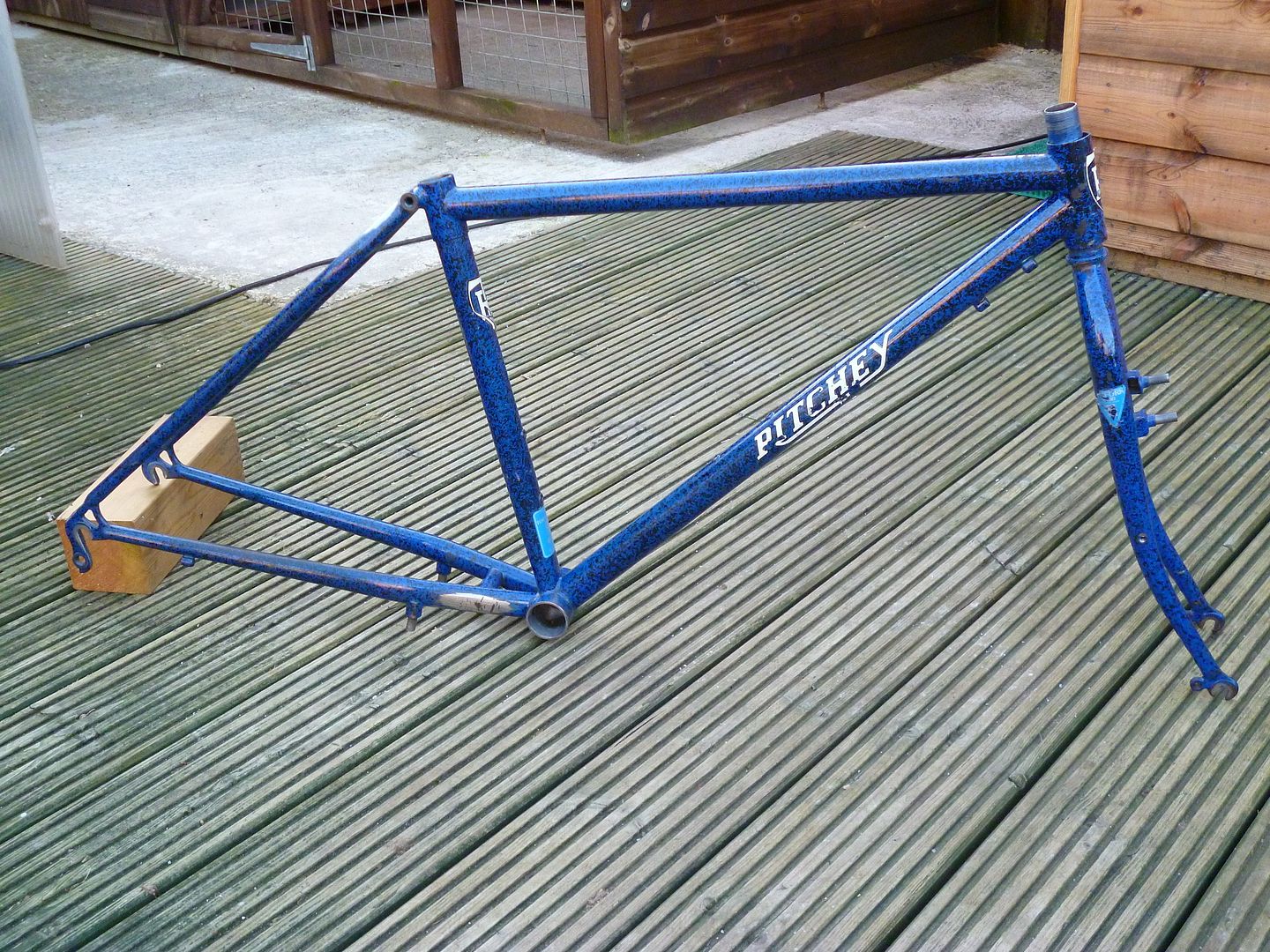

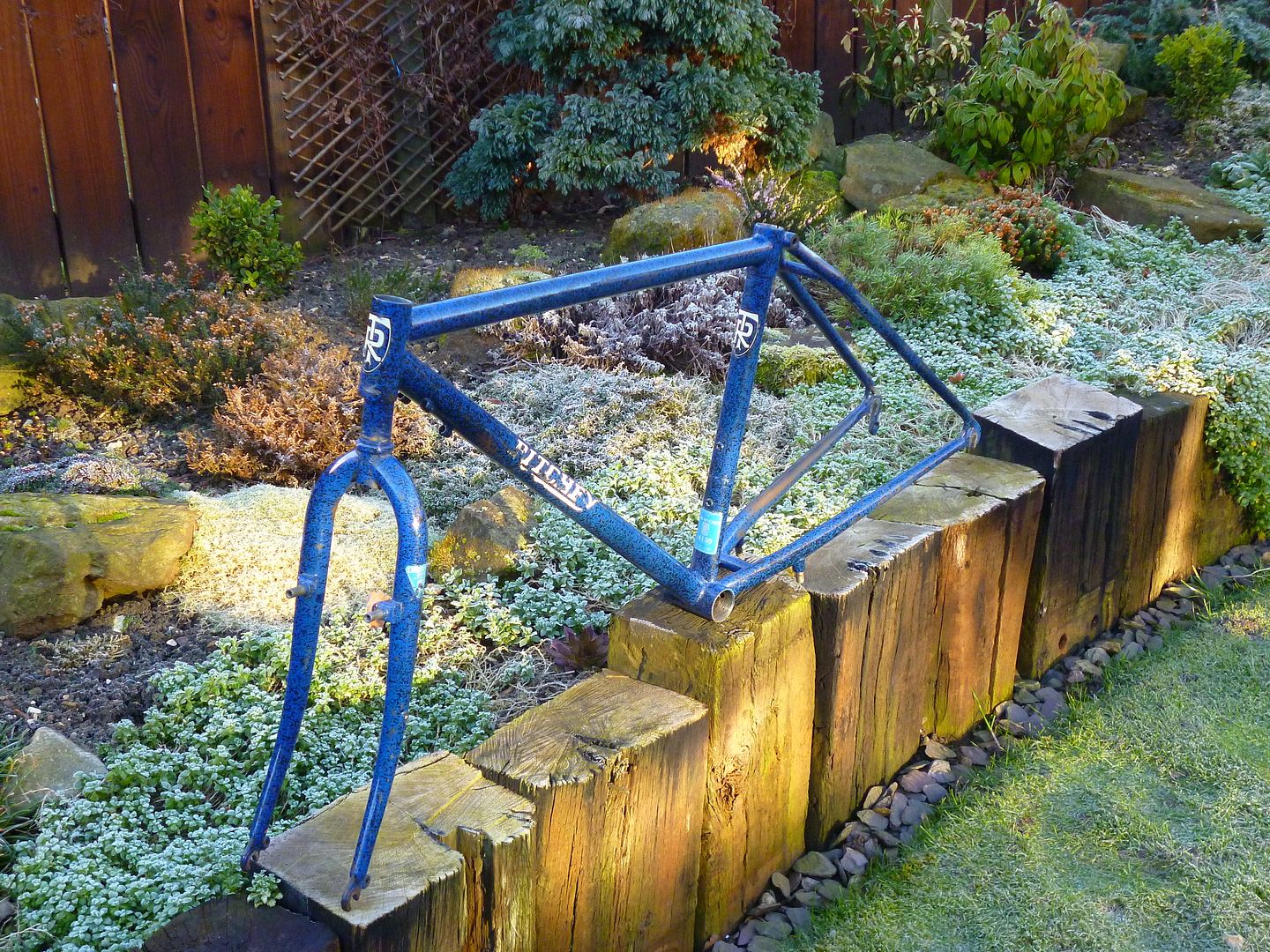

A few pics of the frame pre work,
