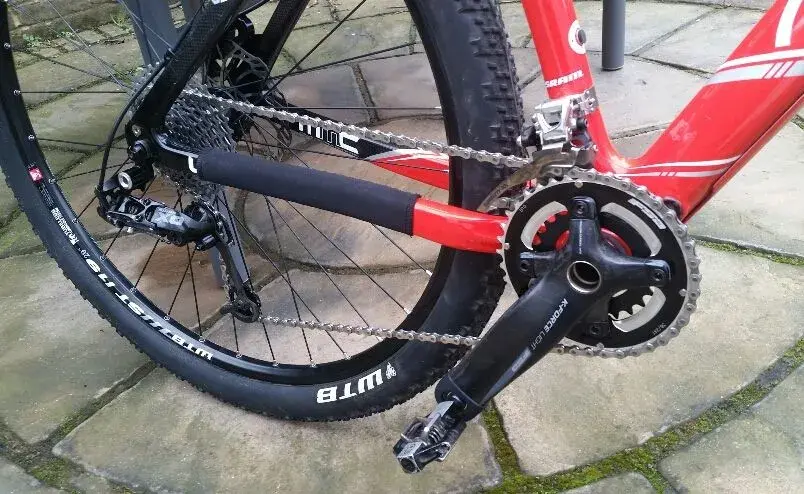

I've got a set of the k-force cranks but I have the mega-exo version so it fits a standard bb shell.
