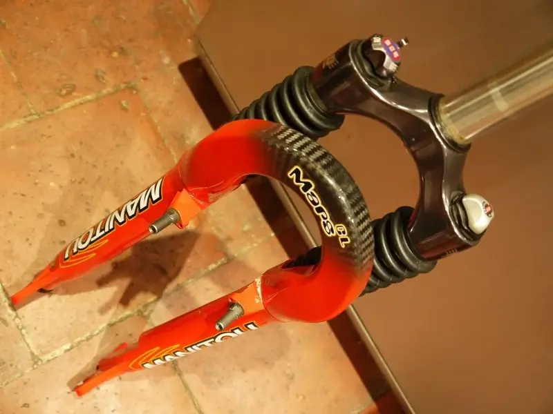

I dunno about period correct (what year is your Trek 8700?), but if you want something to match the red/black/carbon thing then a Manitou Mars CL fork fits the bill...

Those forks certainly have the correct colour scheme.
Period correct Pace forks would be the the 1993 RC35 AB, or the RC35K from the previous year.
You might find a decent working set of those for your budget. And the steerer is swappable on those forks too.
But the performance of a Judy is far better than any RC35 so that would be a downgrade of sorts. RC36 are Ok, I think. But you would have to spend more than 100 quid to get one of these. Same with most forks that would be as good or better (looking) than the Judys.
Specialized FSX either MAG based (period correct) or Judy based (following years period upgrade correct).
Next.
Oh and good luck getting a cheap working set ;-)
The manitou above are a lot newer but should be a fine fork to use. Travel will be longer (80mm?), so use a shorter stem if you go that way.
Any pictures of the bike and Judy's you have now (could be 50/60mm travel or longer already).

Re: Re:
Next.
There 60mm
You might get away with rc36, but they are 70/90mm ish so a longer fork.
If 60mm was fine, you can give it a try.
You may need to alter you seat, stem etc positions.
