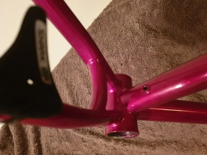

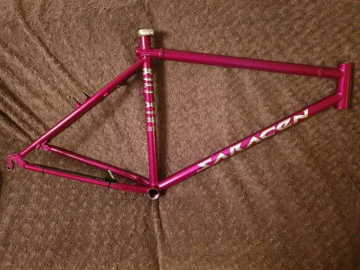

Just starting out a Saracen Kili XTR Elite build, it's got top route cabling, however there is a bolt hole for a pulley on the lower seat tube, so... did this come with bottom or top pull front mech? I'm actually lucky to have one of each in stock, I just can't decide. It's a 1993 model, i've never done a build with a pulley front mech and can't help but think the addition of a pulley brings addition of problems - sticky, possibility of cable jumping off of it etc? Let me know your thoughts...
