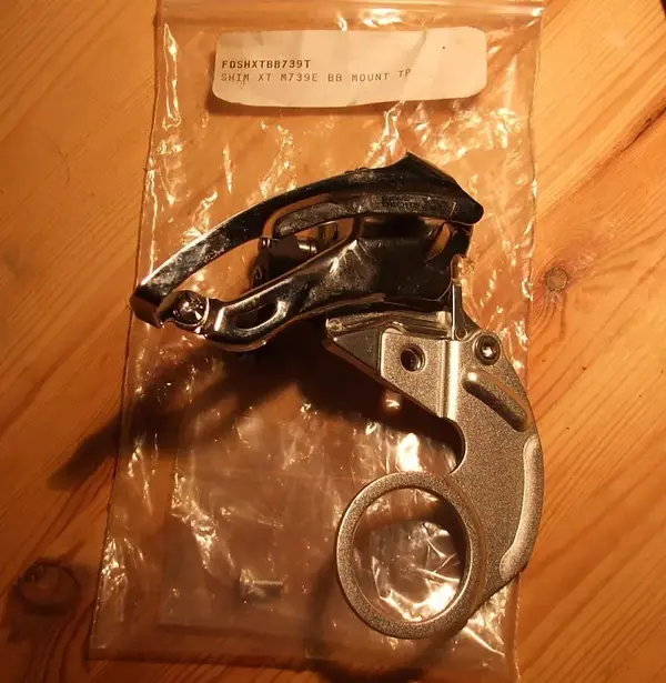

I don't understand - see below an M739 E-type mech. The ring that fits around the bb is perfectly plain. Immediately above it is the hole that you put the bolt through to connect it rigidly to the seat tube. Without that bolt it would be free to rotate around the bb every time you change gear (and in fact you wouldn't change gear and you wouldn't be able to tension the cable).
