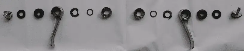

My shimano 600 friction shifters have started to slip dramatically.
It's not just a matter of cleaning them with isopropyl and adjusting the locking D ring.
I think I need a new brass/copper washer or a plastic equivalent.
Any ideas? Many thanks.
Need a better pic than that, but it's probably the plastic washers that are worn. Try some extra washers in there to help tighten them

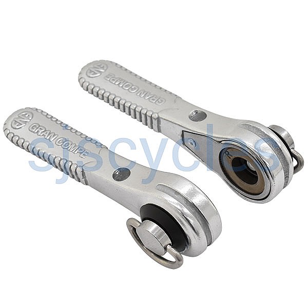

The newer Dia Compe ratchet friction shifters are better, IMO.
