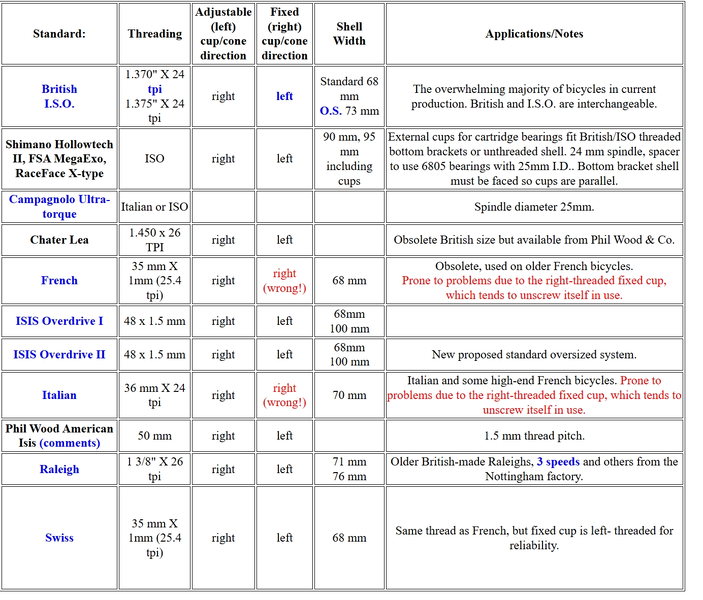

Ah, I see! How do I know if they are left or right hand cup dies (or does it matter, do they cut both?) I've got really old set of french dies from the 1920s, and they are marked left and right. I'm pretty sure they are VAR on account there were a lot of VAR tools in the same lot
French and Italian are both right-hand thread (RH) on both sides. If you have a LH thread BB tap and it's metric, then it's Swiss.

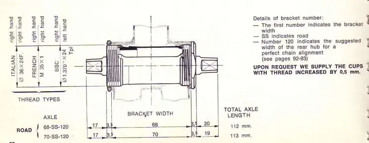

I wonder if your taps are oversized for matching oversized cups. Campy did list 0.5 mm oversized cups as an option, here's a snippet from Catalog 17 (1974):
I assume those were for keeping a frame on the road when its BB threads were wallowed out.
Maybe Var made similar?
oversize Italian cups for repair purposes are very real
