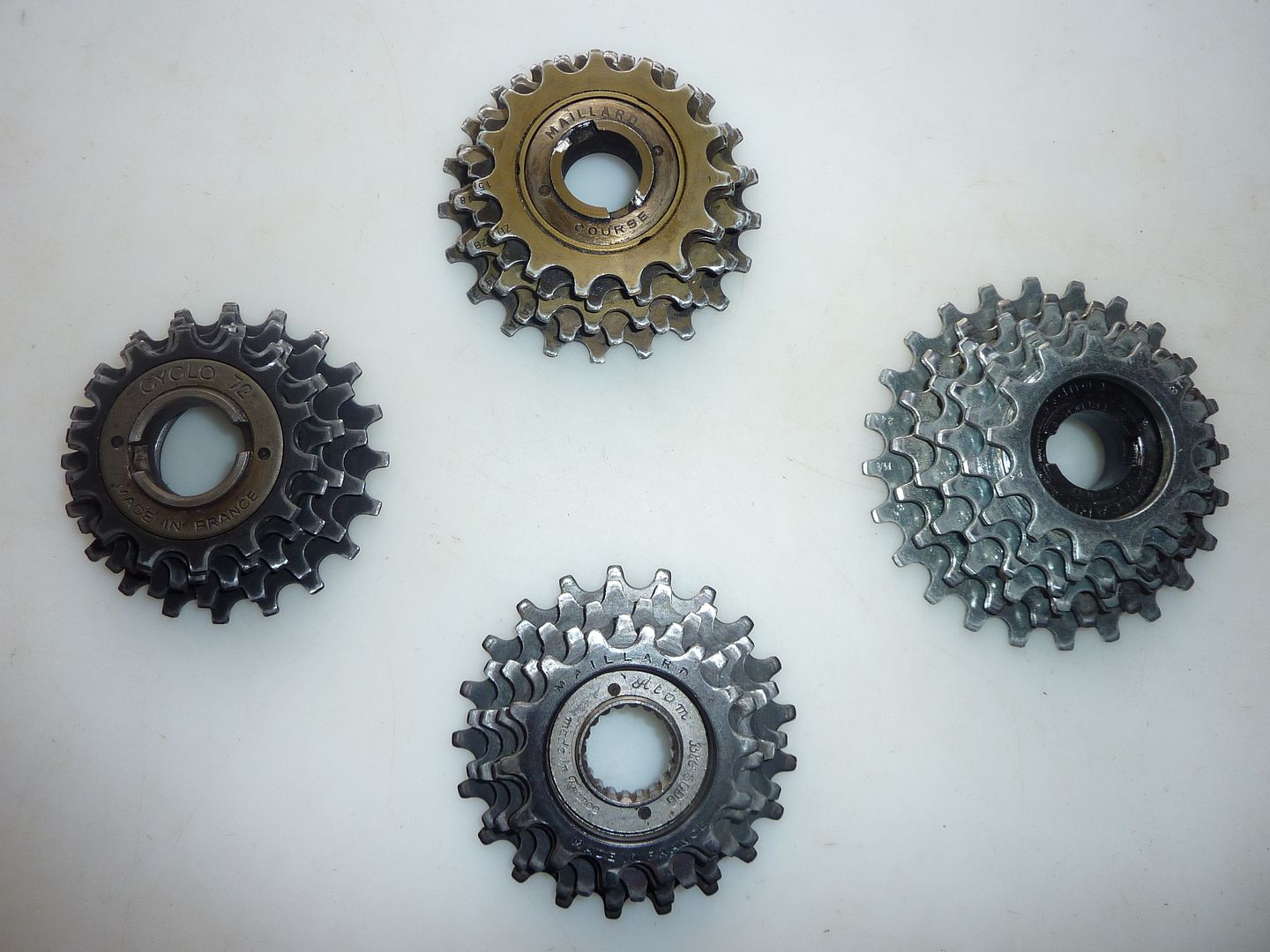

For fun, today, I had a weighing session
unfortunately don't have some regina, zeus, or galli, even everest ones
so its mostly froggy stuff :wink: when they were influential on the roadbike scene - period now not completely gone, but we are outsiders now :facepalm: :roll:
The light alloy Maillard is clearly ahead at 156 g for a 5V ( body weighed at 80 g)
It is sometimes dubbed zicral but the cogs don't have a reputation for durability
The 5V cyclo 72 stands at 294 g
The 5V atom at 327g
The 6V Maillard in steel but with bigger cogs stands at 433g - if I take out the 6th cog 413g
