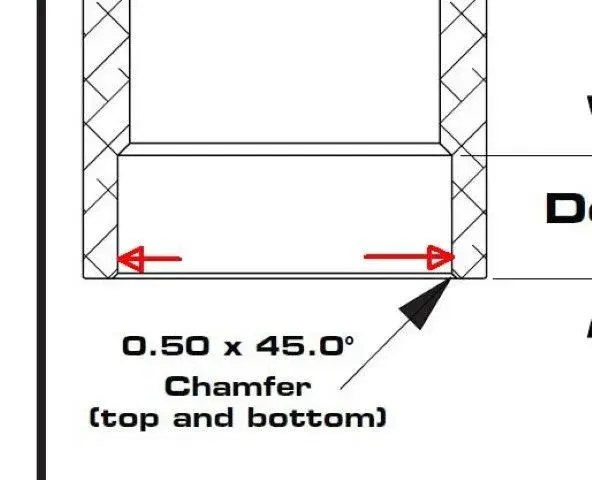

If the Manitous which I have seen are anything to go by, it's a combination of poor large grained material, possibly even extruded billet, for the headtubes that starts the problems. Added to which, their headtubes seem to have been reamed out 0.15mm undersized from the factory, with a sharp square internal corner on the bore, rather than the chamfer shown on the standard specs. They want to burst as soon as they see a porky Chris King headset coming their way!
IIRC some of the better framebuilding tool companies such as Cobra and Silva from Italy used to supply their reamers in 2 different sizes, one for steel and Ti, the other, slightly larger, for aluminium. Aluminium has a hard time coping with the bursting force of a press fit cup...
IMO one of the main drivers behind the move to the tapered bearing integrated headsets in the early 2000s. They may have had other inherent problems, but the negligible bursting force produced is exerted diagonally on a very thick walled tube section, protected well up inside the head tube away from the tube end.

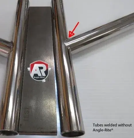

I suspect the Nishiki seat tube problem is down to an already thin walled seat tube distorting forwards and inwards around the TT weld like this:
The resulting internal bulge is then reamed out for the seatpost fit, thinning the tube wall even more at the weakest area just above the weldment...We'll see when I get my hands on it.
