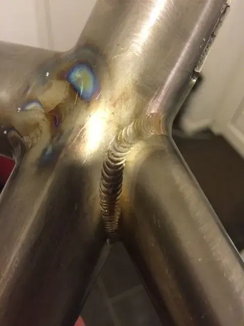

Im hoping somebody here maybe able to advise me.. Recently received an RSP600 titanium frame, and on the drive chain side where the wishbone is attached to the seat tube there appears to be an extra line (or two) of weld/s (pics attached)
Has anyone seen this before? or could anyone comment on the likelihood of this being present on a Raleigh frame of this calibre from that era when it left the factory??
Or, has this been repaired? the welds do not appear to match those on the rest of the frame. The profile doesn't appear to match and the 'extra' ones appear to be thicker and less uniform..
Interested in others views…
I've looked at a fair number of these and never seen that.
Are the rest of the welds have the anodised look or been finished?
Almost definately repair.

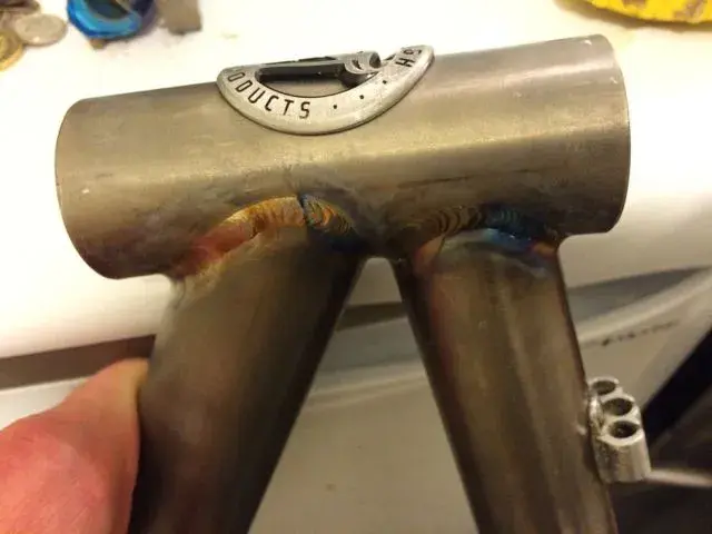

Thanks so much Rampage I think that confirms my suspicions. The rest of the welds are uniform with a gold tinge if thats what you mean?? another pic attached..

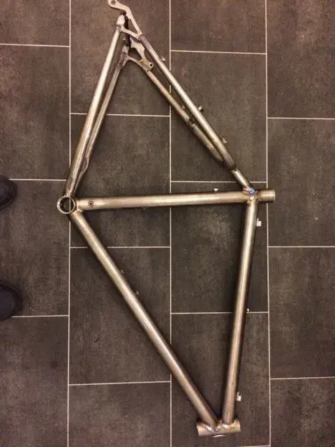

Frame only I'm afraid :/

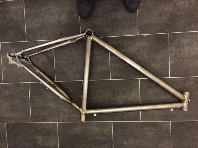

2000 model.
Don't know, I've never seen one with the heat marks left around the welds.

With no canti arch and disc mounts on the rear stay I think its safe to say seller didn't know alot about it deffo not early 90's as described
Gotta agree with Rampage on the age circa 2000

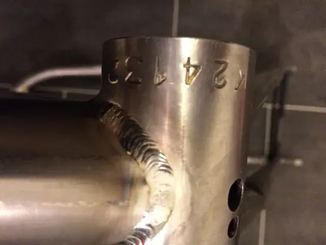

It's 2000 based on the serial.

I remember that frame on the 'bay. I wondered at the time if it had been painted in a previous life, and hence the uncleaned up heat marks.
Either a repair or a friday afternoon frame perhaps.
