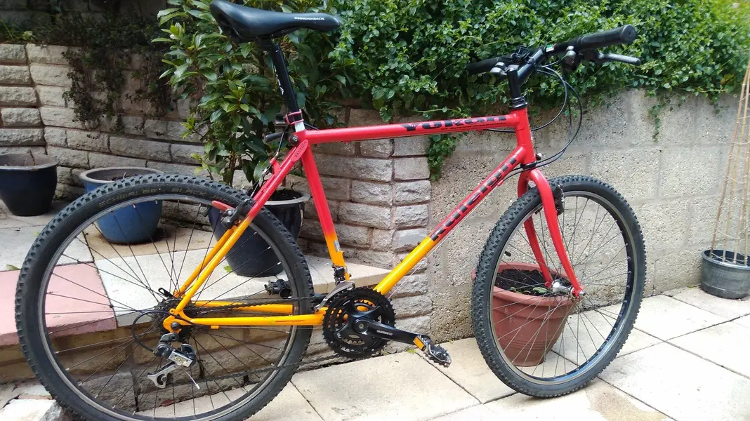

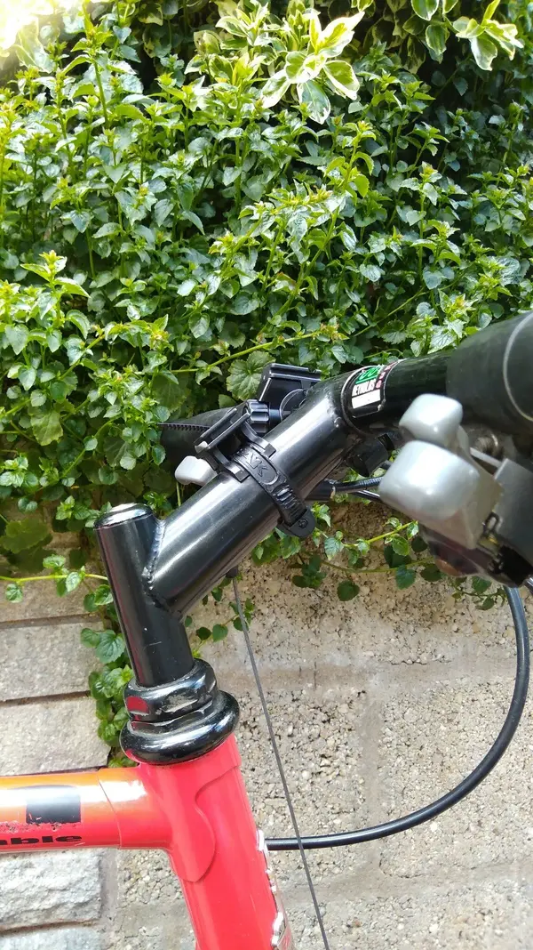

I'm around 6ft and I ride a 19" CtT 1991 or 92 Raleigh Yukon with its original bars and stem, I'd have preferred an 18" (did they even make them in that size?) but I can't grumble too much as I found it in a clearance shop for £35; what I will say is it's one of the comfiest bikes I've ever rode. I'm not sure what length the stem is but it looks shorter and more raised than the ones fitted on mtbs from the mid 90s onwards. I reckon it's possible to ride a few different sized frames with a bit of tweaking of the fit.

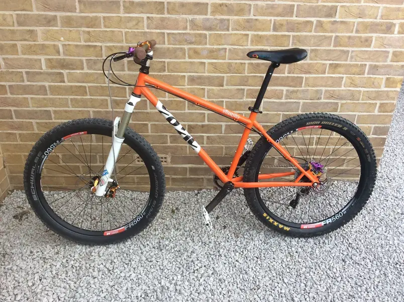

The Complex Simple COTIC now has a super-short stem (35mm) with 40mm Renthal riser bars and rides brilliantly.
