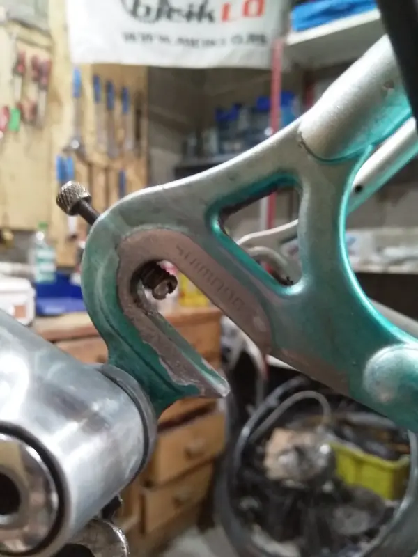

LWC Retro Newbie Apr 15, 2021 #1 hello, I need help to identify this frame. It has Italian BB. There is no marks on rear dropout. On front drops there is shimano mark. Thanks Last edited: Apr 16, 2021
non-fixie Senior Retro Guru Apr 16, 2021 #2 The serial number looks Asian, and the format is consistent with Matsushita and Toyo. 70mm shells on Japanese frames are not unheard of, but they usually have BSC threading.
LWC Retro Newbie Apr 19, 2021 #3 Update> It have shimano rear dropout and tange 60l fork Attachments IMG_20210417_165107.jpg 242 KB · Views: 1
