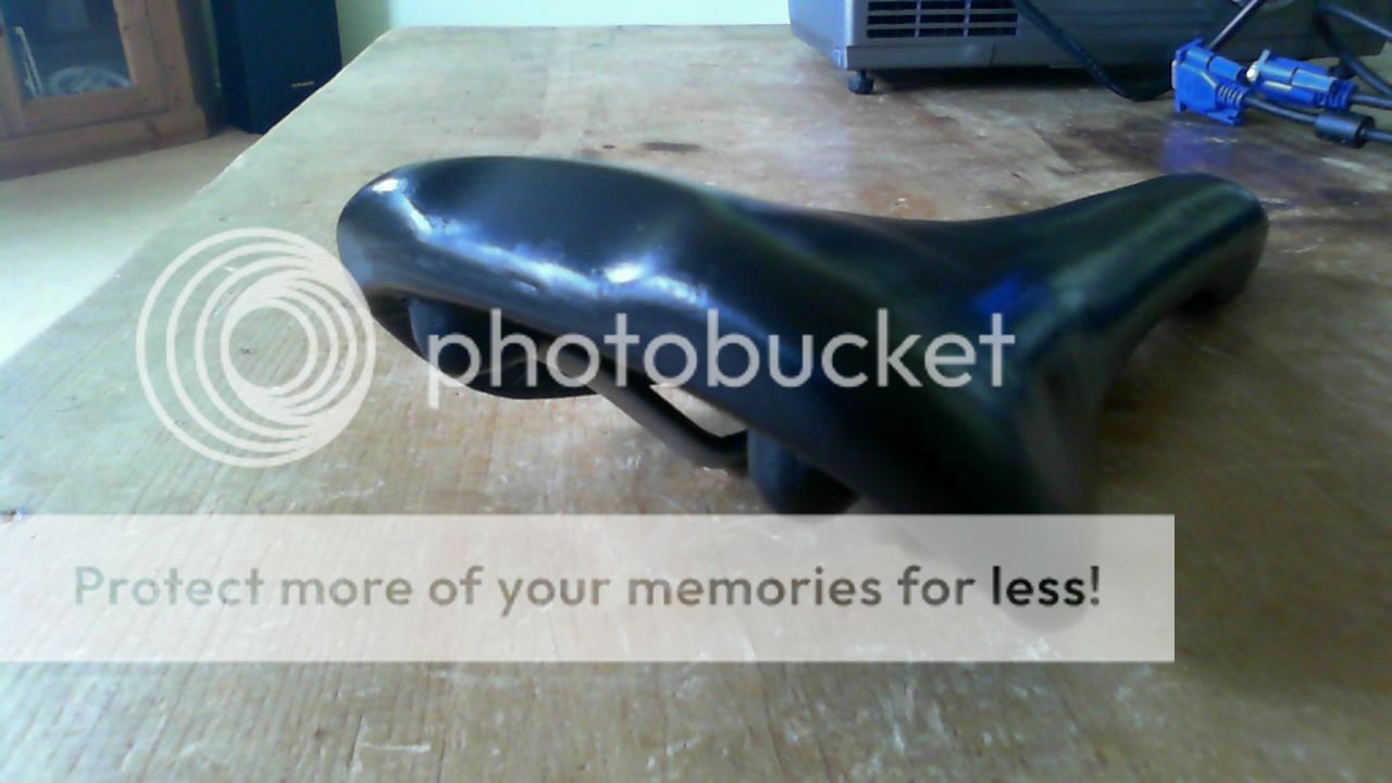

When i got it it wasn't too bad, wear on the nose and both sides and the rear had a tear and wear.
Seemed too good to re cover and i had come across some leather filler recommended by enc on another thread so decided to order some and give it a go.
http://www.ebay.co.uk/itm/380919377230? ... EBIDX%3AIT
I used their instructions on line and filled in the tear pretty well.
I also ordered some of their colourant/dye for the worn patches:
http://www.ebay.co.uk/itm/271060005689? ... EBIDX%3AIT

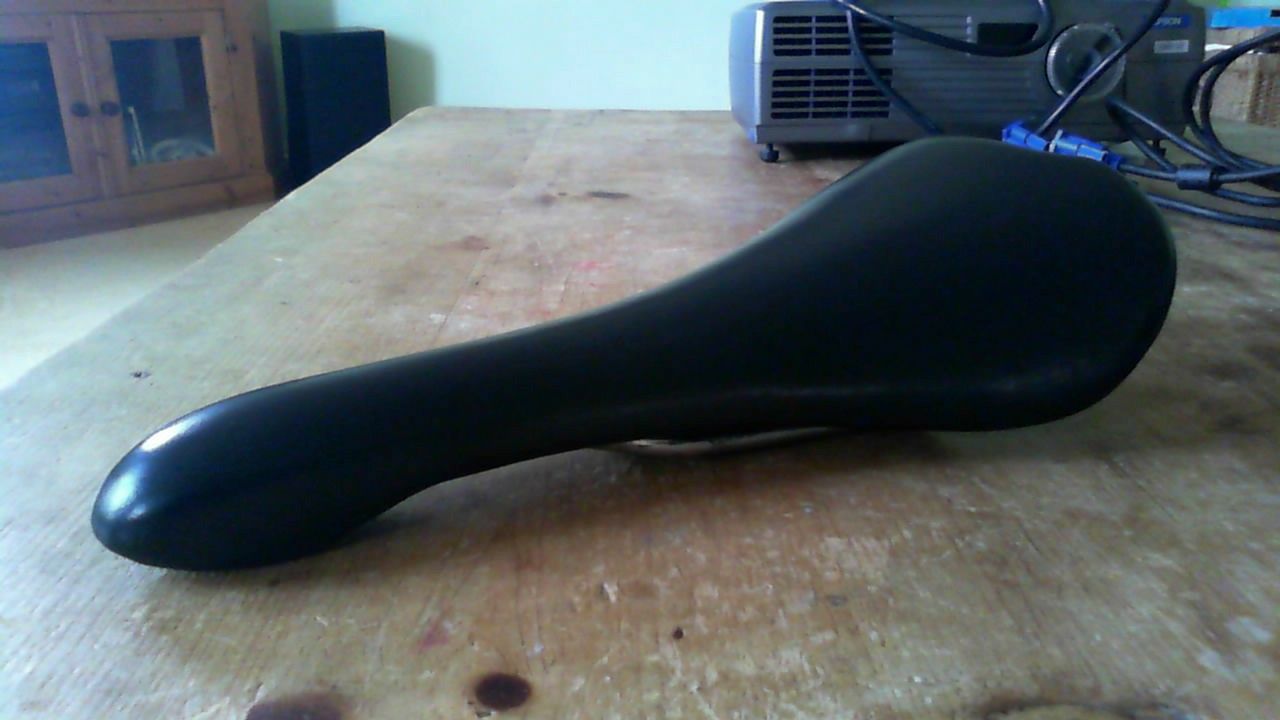

Again i followed the instructions online but it's pretty simple, just sponge it on after sanding the whole saddle surface with 1200 grade sandpaper.

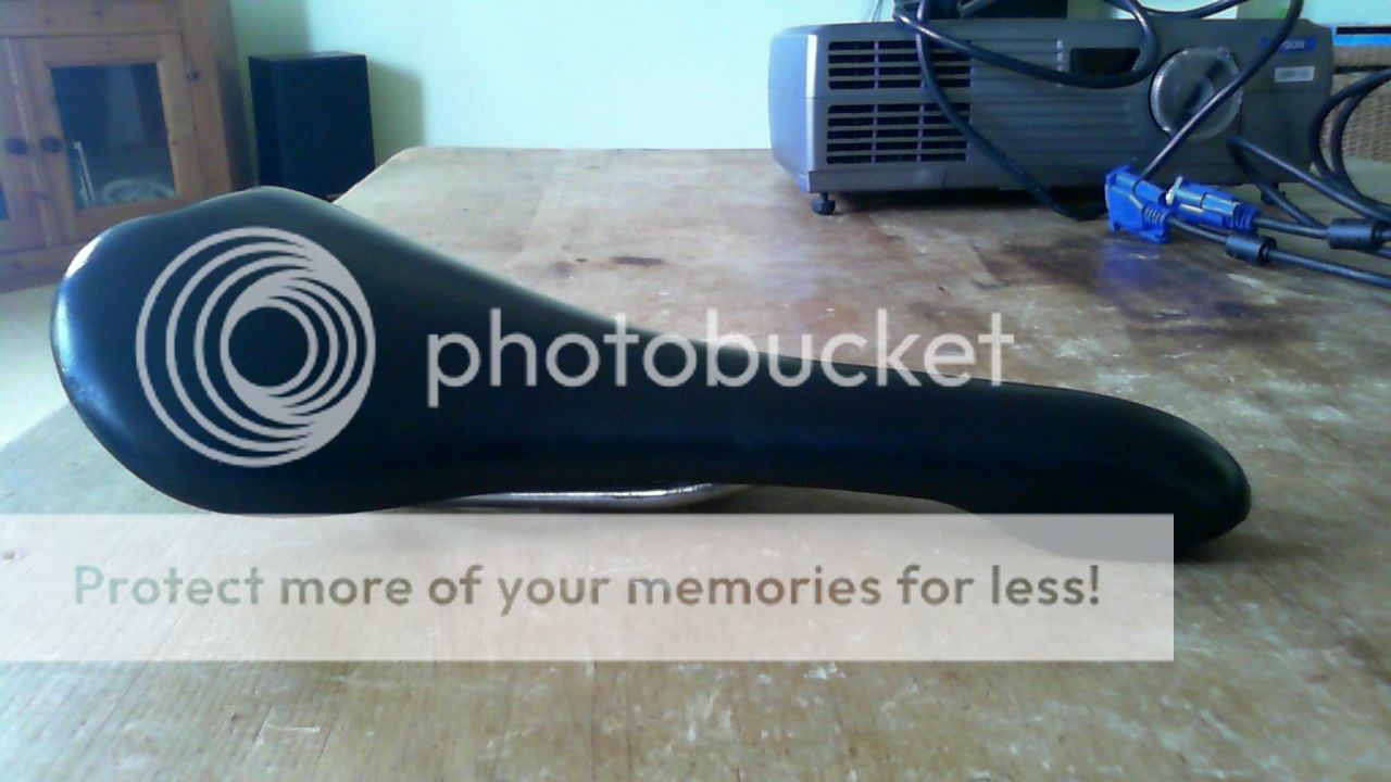

It took about 8 coats but when finished and left for 24 hours i'm pretty impressed with the results :D
And it is also waterproof!
What do you think?
Don't wear your favourite white lycra shorts on the first ride, just in case :wink:
Seriously though, it looks good G! 8)
Mike
The colourant is meant for use on leather car interiors and sofas etc so does not come off. I have tried rubbing it for a while with a wet cloth and nothing came off. Water just runs straight off like it's got a gortex coating!

Doesn't cost a lot, and i got 2 bottles for the price of one so plenty left. I used the dye over the whole saddle surface to get colour uniformity and sanded once, before coat 5 or 6 and the a couple more coats to finish off.
They do do different finish coats you can add afterwards, either matt, silk or gloss but i don't think i need to add one as it looks fine to me.
Do you think this would work on a small tear, or just with general scuffing? I just picked up a nice perforated Turbo, but it has a ~ half inch tear. Wondering how I might fix it.
